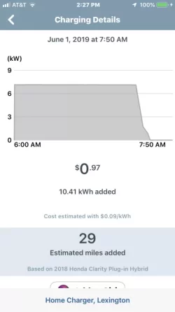

You do get the flat line after charging is over and it would go on forever if you didn’t set a stop time. So with a start minus stop of 2.5 hours, I see the charging and then a short amount of flat line. But I get notified as soon as charging goes to zero as opposed to when the schedule is set to stop.
Here’s an example of a 10.4 kwh session. On the app, you can hover over any point to get the kWs. Max is always 7.2 to 7.3 kW.
