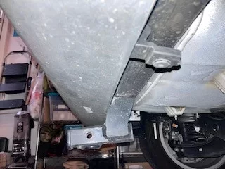

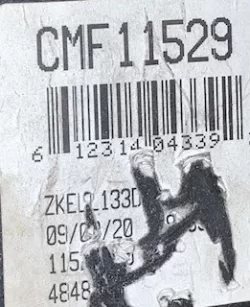

There are no cuts to the plastic... Our Hyundai dealer was willing to order one and install for $550! It was $250 just for the labor. That is why i went to U-Haul as they do installs on a daily basis. I believe the second pic is the upc for the hitch. kona 2020 ultimate ev trailer hitch.webp upc uhaul hitch..webp From what I gather on this forum, there are a couple of different hitchs that work. I do believe that the year matters, as the one for the 2018 was not the same as the 2019 or the 2020. Good Luck

Hi, and thx for the info. Please clarify that the hitch you had installed was the round tube type (as per the first photo) and Not the square tube type in the installation diagram...

mine is the same model number Manufacturer Part Number: 11529 as in the picture and it is a square tube type. I have never seen a round tube type I have the 2020 model kona ultimate ev and i am in the states
I'm interested to know how they got it through the splash guard without cutting it. Did they just leave it off? That does not look like any of the other installs I have seen on here and it does not appear to match up with the underside of my 2020 (albeit mine is a Limited though I don't think that makes a difference).

It is not a round tube, it is a square tube. This is the hitch, by Curt, but supplied by U-Haul.
https://www.curtmfg.com/part/11529
And yes, U-Haul had to cut some plastic for the install. Did a really nice job. And very cheap, incl a lifetime warranty. Start reading at post #32 for all the details.
