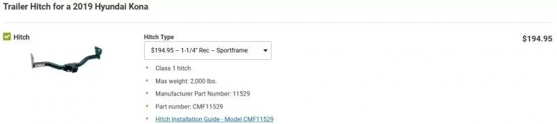

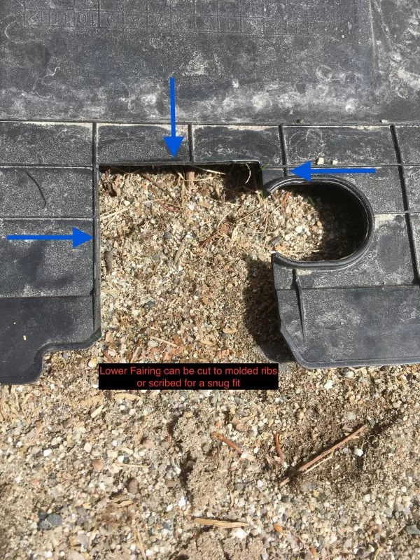

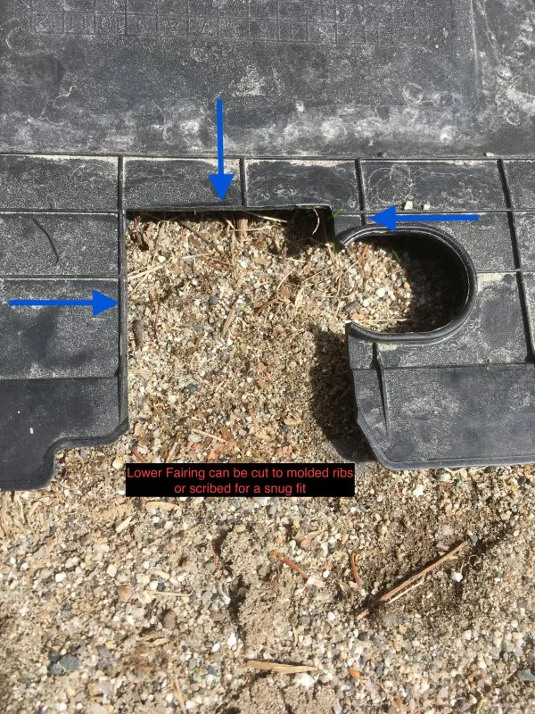

2019 Kona Ultimate - Installed a Curtis hitch procured from the UHaul website (part # CMF11529, $200CAD shipped, was back ordered about a month). Use it with a Thule two-bike bike carrier and a strap connected to the rear door to keep the bike rack from bouncing around.
Had to cut the plastic cover underneath the Kona and it was a tight fit, but otherwise, it worked fine.

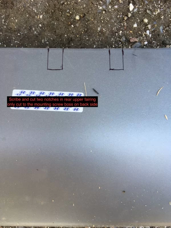

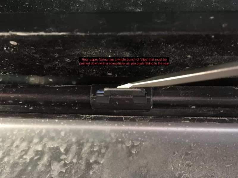

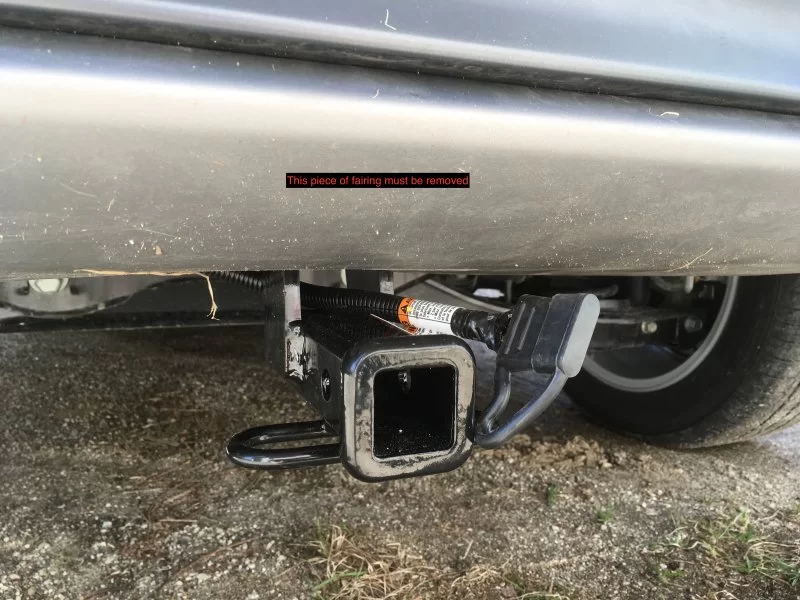

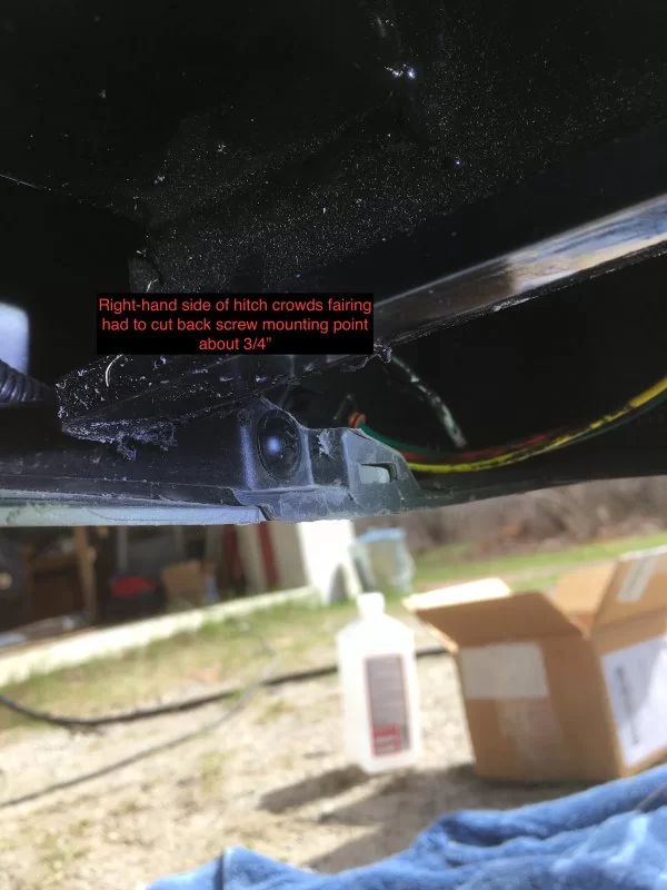

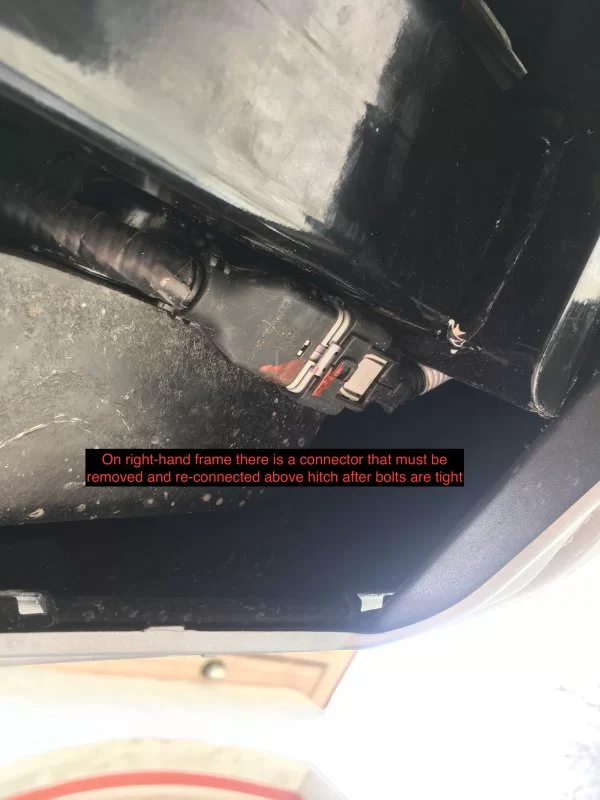

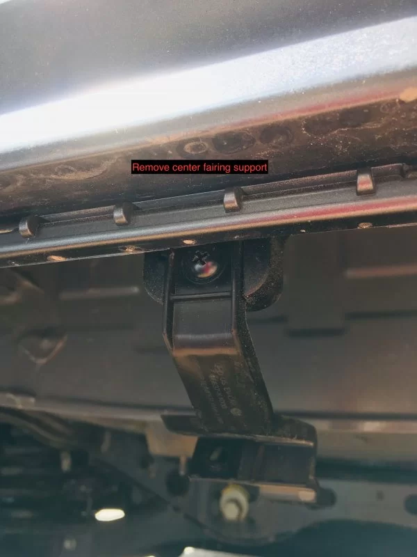

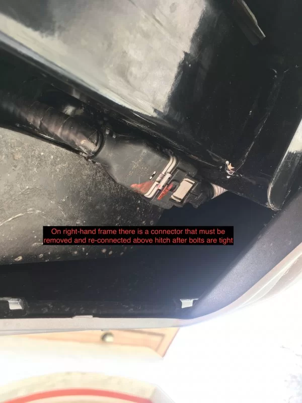

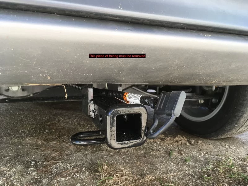

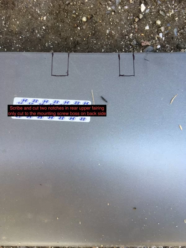

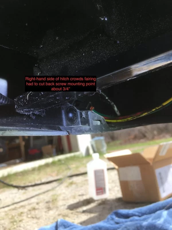

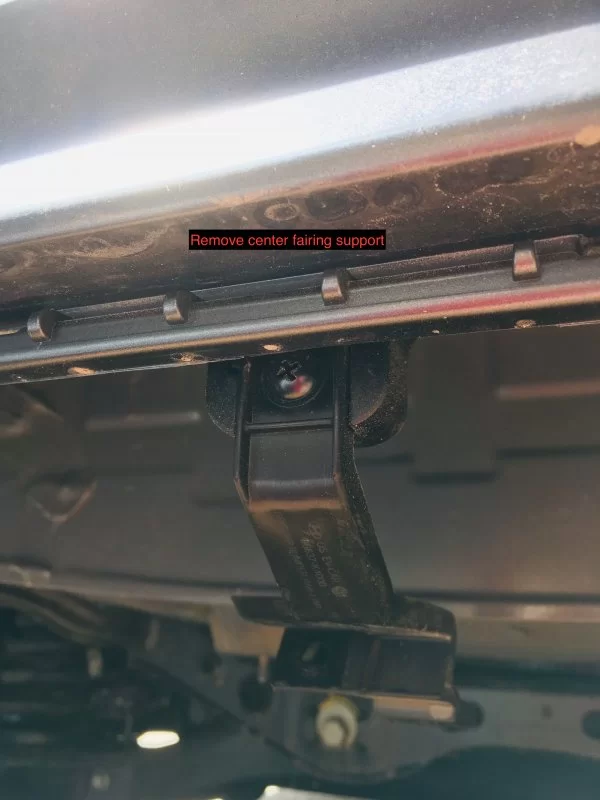

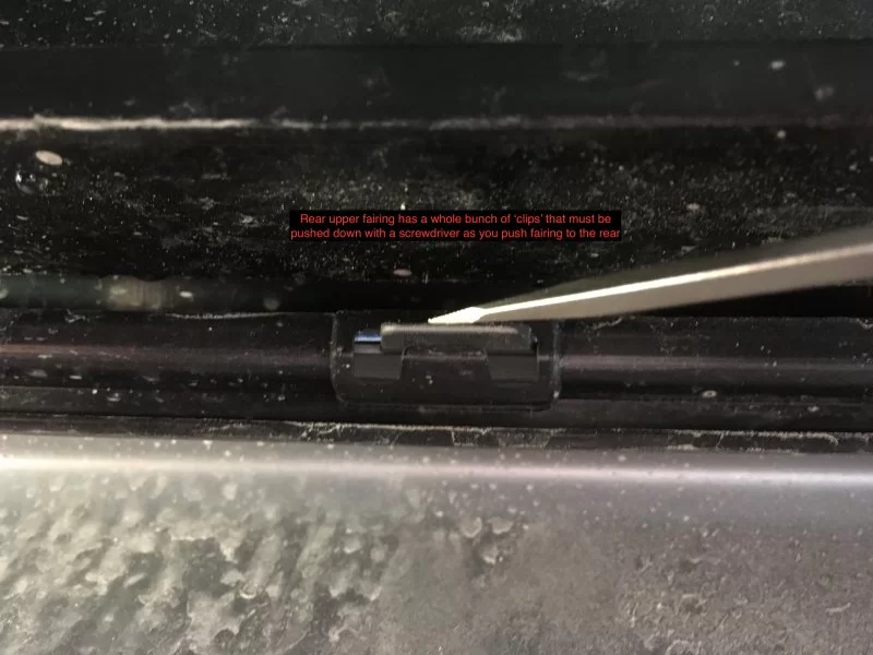

Thank you very much for the pictures of the installation. I was told by "U-Haul" that the gas Kona hitch would fit our 2021 Kona ev by trimming "some plastic".
Your pictures show me what parts need trimming! Btw, I bought the hitch with a 2" receiver because my bike carrier is 2"
I had mine installed by a local U-Haul shop, they were puzzled for a few minutes when they called their dealer tech support and they didn't know what to do either. They eventually figured it out, sometimes they have to do similar trimming for other makes/models to get hitches to fit.
