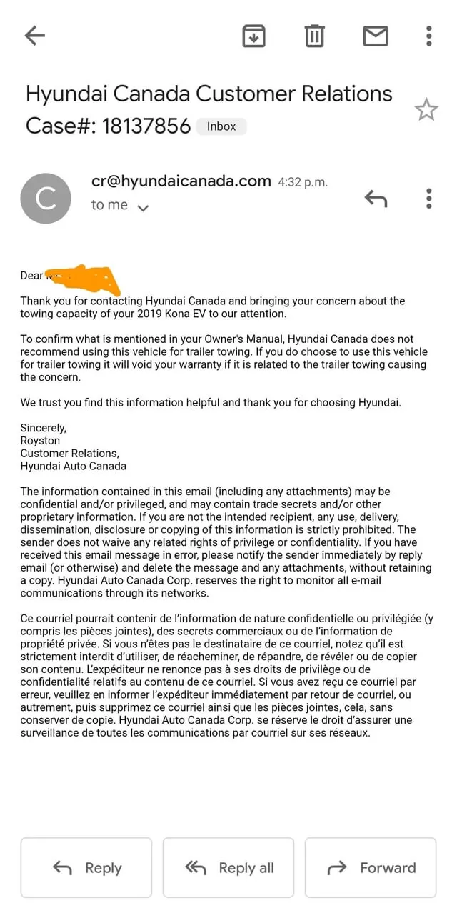

Well at least here in Canada, having a hitch seems to be ok but if they can make a link to a problem being related to towing it looks like they will void the warranty on that concern. That could be anything related to drivetrain, suspension, even electrical especially if you have an aftermarket wiring harness installed. I found this email from Hyundai Canada on reedit

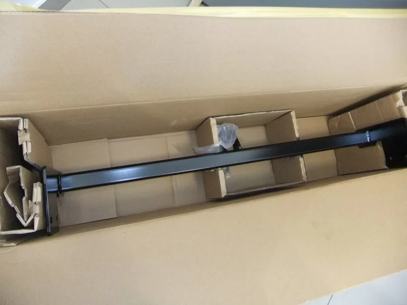

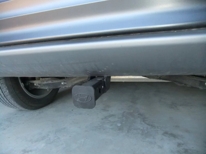

So the Hyundai "accessory frame" is on and my swagman bike rack fits perfectly. My cost was $Cdn270 plus tax installed. Not sure why I got a discount from the usual $Cdn335 but it was appreciated anyway! The bumper had to be taken completely off to install it. Part number is J9H03 AP000. Since it was an OEM part for the Kona and dealer installed I don't expect any warranty problems, considering how complicit the dealer is now. We had a little chat about not trailer towing and since I don't intend to it's a perfect solution for me. FYI - The accessory frame has no loops to attach trailer safety chains. I noticed that the dealership used the words "trailer hitch" on the invoice, lol.

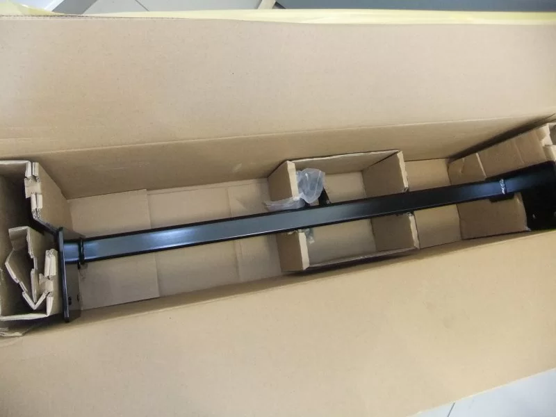

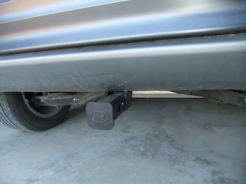

View attachment 11519 View attachment 11518
Did they take out the under panel? I had mine installed and I just cut out enough to get the hitch receiver through and reinstalled it to keep the aerodynamics.
