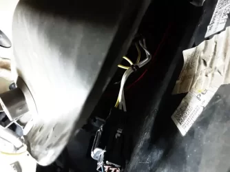

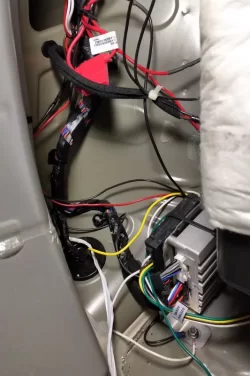

So, I thought I’d share my experience of both adding trailer wiring and the hitch, to add some additional info or tips to that which is already on the web.
The first thing I started with was installing a trailer wiring harness. I didn’t want to cut any factory wires, so I ordered the “Curt T-Connector Vehicle Wiring Harness with 4-Pole Flat Trailer Connector” Item # C99KR, from etrailer.com. $77.31 shipped. It has OEM harness adapter plugs that connect to the original Hyundai plugs.
To install the wiring harness, I followed much of the “Curt T-Connector Vehicle Wiring Harness Installation - 2020 Hyundai Kona” video.
A few differences:
At 5:25, I chose to cut a slit inside the ring of the rubber grommet, and push the lower connectors through rather than cutting the grommet from the outside in, so that the outer ring remained unbroken. A little difficult, but the grommet ring remains unbroken. I also chose to keep the 4-pin trailer ribbon cable inside the vehicle, and will simply bring it out the hatch when towing.
I didn’t hook up power as described from 5:44 – 7:58.
Because of issues with 12V batteries and EVs, (I’m already on my second battery), I wanted to power the trailer harness from a circuit that is only powered when the car is on. I previously had installed a switched 12V outlet in the rear cargo compartment (described here in #252), so I tapped the positive lead into this wire, and connected the negative lead to the existing grounding screw by the stereo amp. This also was a convenient place to mount the trailer converter box using the supplied 2-sided tape and zip ties. No self-tapping screws needed! (01_Mounted.jpg)

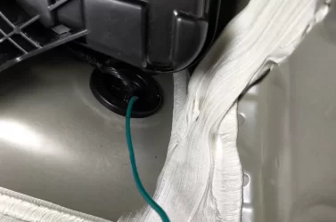

At 9:00, I again chose to cut a slit inside the ring of the passenger side rubber grommet, and push the lower connectors through. (02_Pass_Side_Grommet.jpg)
From 9:09-10:44, the video explains how to attach the harness to the rear lights. There was no way on God’s green earth for me to contort my arm and hand to reach the plugs, so I used the steps described from 3:25 to 4:34 in the “2019 Hyundai Kona Trailer Wiring Harness Installation” video. This involved removing some Phillips screws from the wheel well, pulling back the plastic, and attaching the harness ends. This was WAY EASIER!
Other than testing the completed wiring, and sealing the grommet cuts with the black silicone in the wire harness kit, I skipped the rest of the video, which only explained how to wire to the battery.

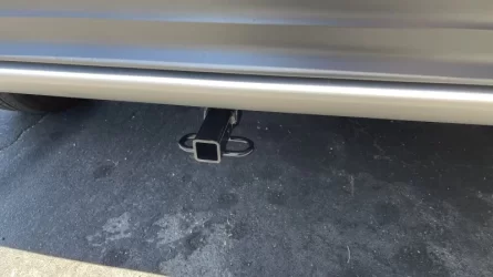

Now, following my visit to the welding shop that un-bent my Draw-Tite hitch so that actually fits on the car, I continued……..
I referenced the video “Installing a etrailer.com Draw-Tite trailer hitch ona Hyundai Kona EV (2021)” which followed the hitch install on a Kona EV.
However, when it came to fishing the bolts and installing the hitch, I reversed his order because I felt it was too hard to hoist and exactly position 35 lbs of steel while delicately fishing 4 wires and bolts through the car’s frame rails.
Instead, I positioned the hitch into its correct position, and used some spare large machine bolts I had, inserting them temporarily in from the outside, through the hitch, into the frame rail. This held the hitch in place. I then removed one bolt at a time, and fished through the hitch and frame rail to pull out the actual mounting bolts. This worked well, and only a little jiggling was needed to pull through the bolts, and install the washers and nuts.
After getting all four nuts on loosely, I wedged the hitch up as high as possible to provide panel clearance, and torqued to 50 ft-lbs as directed.
Reinstalling the bottom plastic panels went the same, except at 9:30, I used a grease pencil to coat the bottom corners of the hitch mounting plates, and pushed the plastic onto them so that I could easily tell where to scribe out a notch. As such, I was able to make the notches quite narrow and close to the mounting plate, and also didn’t need to cut through the complete top edge of the plastic, keeping some of its rigidity. (It ended up the same as Dag Lindquist posted at #21 in this thread.)
Overall, I’m glad the Draw-Tite hitch did eventually fit, and I’m happy I didn’t need to cut any wires and could power the kit from a switched 12V circuit. Good luck to anyone deciding to do the same project!
