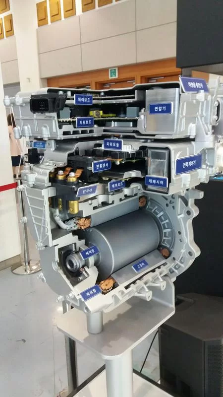

Is this a problem solving itself (high power cables?), or am I on the cusp of a massive failure of some component?
Do inverters fail? I assume if they do, the symptoms would be lack of charging or a warning light?

BTW, if it is an inverter, then I do consider it a safety issue. The Nissan Leaf had some early inverter failures that left people stranded. So what we need is a definite answer from Hyundai.

Hyundai sent a specialist engineer in to have a look at the car. They deemed it was likely a wheel bearing and have ordered the complete assembly for replacement - onto the topic at hand!
I had the engineer have a listen to the hiss noise described in my above post. They put it on the hoist for about an hour and have since let me know that they believe it to be a "low-gear drive unit". The gentleman likened this to the EV's "Transmission" for lack of a better description.
They went ahead and ordered a replacement from Korea but unfortunately told me that because the units are all being destined for the assembly line - there may be a wait of several months.
He did warn me that there is NOT a different revision number from my car's part to the new part so there's a very likely chance that the replacement will not resolve the issue. But because I referred him to this forum and it seems that not everyone is having this issue, it seems to be hit or miss. He mentioned that he would also report back to Hyundai and because this is the "first" unit that they've had a look at, they would likely keep my old part once replaced and take it back to Korea for further analysis.
He absolutely agreed with me that the car should NOT be making that sound and that if it is indeed a faulty part - all units would be recalled and replaced.
So that's that! Now I wait here patiently for up to two months like the gentleman told me. But this is by far the most positive outcome of this issue to date!
