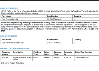

What Fuel Pump Motor Kit part # is shown on your recall paperwork? See below.
Also note that the failed part ends in A01. It had been discussed previously on this thread that the fuel pump, that is subject to the recall and, was installed in 2018-19 Clarities, ended in A00. And that the A01 pump, which is believed to have been used in the 2020-21 Clarities which are not subject to the recall, may have been a suitable replacement part.
Below are the particulars for the CRV. Both part numbers, Motor Kit and Failed Part, are different from the Clarity.
Of note, the CRV part ends in A00, however it is preceded by TLA, rather than TRW for the Clarity. Both part numbers begin with 17045. Perhaps those similarities led to the misconception that the 2018-19 Clarities had a fuel pump part number that ended in A00.

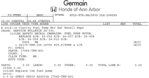

Here's the relevant part of the (no-charge) invoice for the replacement of the fuel pump. The technician spent less than an hour replacing the fuel pump, which was accessed though a panel under the rear seat of my 2018 Clarity (its S/N ends in 001244). The fuel pump's part number is 17045-TRW-A01.
The part number for the Fuel Pump Motor Kit that was used on your Clarity to satisfy the recall is 06170-TRW-305, as shown on the paperwork. It is the part specified for the Clarity. It is not the part specified for the CR-V. The fuel pump part number, 17045-TRW-A01, is the part that was subject to the recall.
If you aren’t terribly concerned that your dealer’s service department is trying to pull a fast one on you, you could call them to confirm the information provided above.

I had my fuel pump recall service completed yesterday. To confirm what others have said, the part number listed on the invoice was 06170-TRW-305.

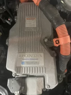

Second, as I parked in my garage and selected park after coming home from the dealer, I heard a distinct, loud click that I believe I have never heard before. My wife agrees. With testing, I discovered no matter the drive mode selected (P, R, N, D), each selection results in the same loud click. Tracing the sound, the click comes from pictured module, or perhaps directly below it. Is this clicking something others have noticed in their Clarity? (Independent of the fuel pump job.) Assuming this is indeed a new and abnormal sound, any thoughts on why my car is doing it after the dealer had it for the fuel pump job (which I assume involved only work back in the fuel tank)?
I did have some gasoline smell after the repair and it dissipated in a day or so. I haven't heard any clicks though but will keep my ears open.
