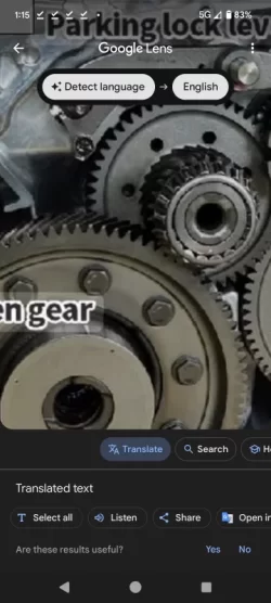

Honestly only reasonable in context of I've tired every else lol. If I had to guess this is where the failure is (final drive to final driven) (this picture is actually from the transaxle of a Honda fit hybrid, but it mechanically is almost identical to that of the clarities tansaxle. I might get a horoscope and see if anything is visibly wrong without taking the thing apart.
What if you drained / filled the transmission and carefully looked for metal debris in the old fluid?
I might also expect that the drain plug is magnetic to aid in capturing metal particles, but I have no confirmation of that...
