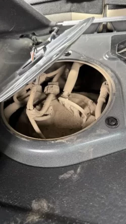

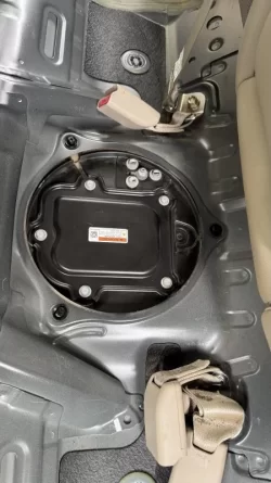

I took off the seat and opened the round access panel and found “High Voltage” warning, so I pulled up the ‘carpet’ in the trunk and found the access panel that actually leads to the fuel pump.
My guess is that most Honda’s have the fuel pump under the seat and the admonition to clear the seat does not actually apply to the Clarity - instead you need to make sure the upper part of the trunk is clear.
