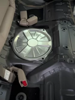

For those with inquiring minds...the picture below is of the access panel under the rear seat of the 2018 Clarity. No real mystery.
Took literally 7 minutes to remove the seat including figuring out where the clips were etc. I remove the seat myself so I can limit consternation in the shop and to speed up the process. It also affords me the ability to inspect the project and pretty much ensures the area will be thoroughly cleaned.

Thanks for showing us that access panel. I didn't expect it to be so beautiful!
@Clarity_Newbie, as you continue imparting valuable knowledge about the Clarity, your "@Clarity_Newbie" handle increasingly fails to represent your stature in this forum. (That, from a forum member stuck with a handle based on a completely different hybrid car he bought 26 years ago.)
