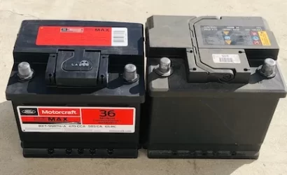

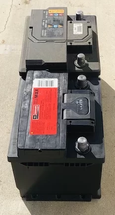

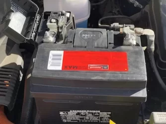

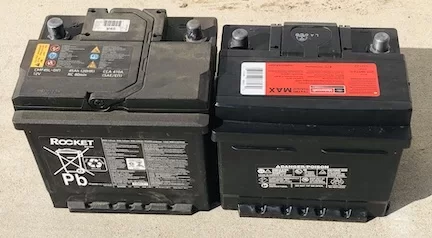

Thanks for all the info everyone. I have a 2019 Niro EV and the 12V auxiliary battery died on Super Bowl Sunday and then again twice more in April. One time my wife had left the hazard lights on for a few minutes while unloading the car. The final time it may have been the headlights after the car was off, but in all the cases, it didn't take much to drain the 12V battery. The second time we got it jumped by AAA and the tech said that since it was almost 4 years old the battery was at the end of its useful life so we bought a Gooloo 2000 Amp Battery Jump Starter and it came in handy a few weeks later. Those things are really easy-to-use versatile gadgets and great timesavers.
After reading this forum and looking online for a replacement battery I realized how difficult it was to find proper information on what to get. This forum was probably the most helpful as the Niro owners manual is very lacking in information. It really doesn't tell you anything about the auxiliary battery and replacement info. My OEM battery was the Rocket battery CMF45L-DIN, manufactured in Korea by SE Bang. The battery group size is 99R, or T4. Group sizes 140R or H4 are apparently also similar battery sizes and may fit, but do verify that on your own.
After looking at the limited choices online, I settled on a Ford Motorcraft BXT-99RT4-A battery for $152 plus tax (bought through my local Ford dealer). This 470-amp Motorcraft battery has as good as or better specs than more expensive models from Interstate, Napa, Duralast, etc. and came with a 3-year warranty, so I thought I'd give it a try. It is just a little bit shorter than the OEM, but it fit in perfectly and started right up. I thought I'd have to reset all my radio stations after changing the battery but those were saved. Time will tell if it's a good battery. Here's some photos of the two batteries side by side and the Motorcraft replacement installed in our Niro.
