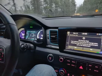

First time draining our 12V battery. Simply started the vehicle while plugged in to warm, then unplugged. A little while later the vehicle started freaking out when we were ready to leave. Simply amazing this lack of foresight exists with the e-Niro, even more amazing knowing all previous Niro models were either hybrid or PHEV (larger battery storage available).
We popped the hood, verified battery voltage was below 12V. Didn't have time to charge it parked, instead relied on the DC/DC converter after a few ignition resets. Vehicle was showing a whopping 1 kW for all electronic consumption during our 40 mile journey, about 500 watts over nominal with the heated accessories. I'm assuming the excess is for 12V charging?
Bottom line, amazing I can intentionally and mistakenly drain the 12V battery with 50+ kWh of available stored energy! Inexcusable.
It's fitting, I guess, for the "EV" software to show us this message (picture) on the first drive following this fiasco.
