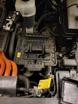

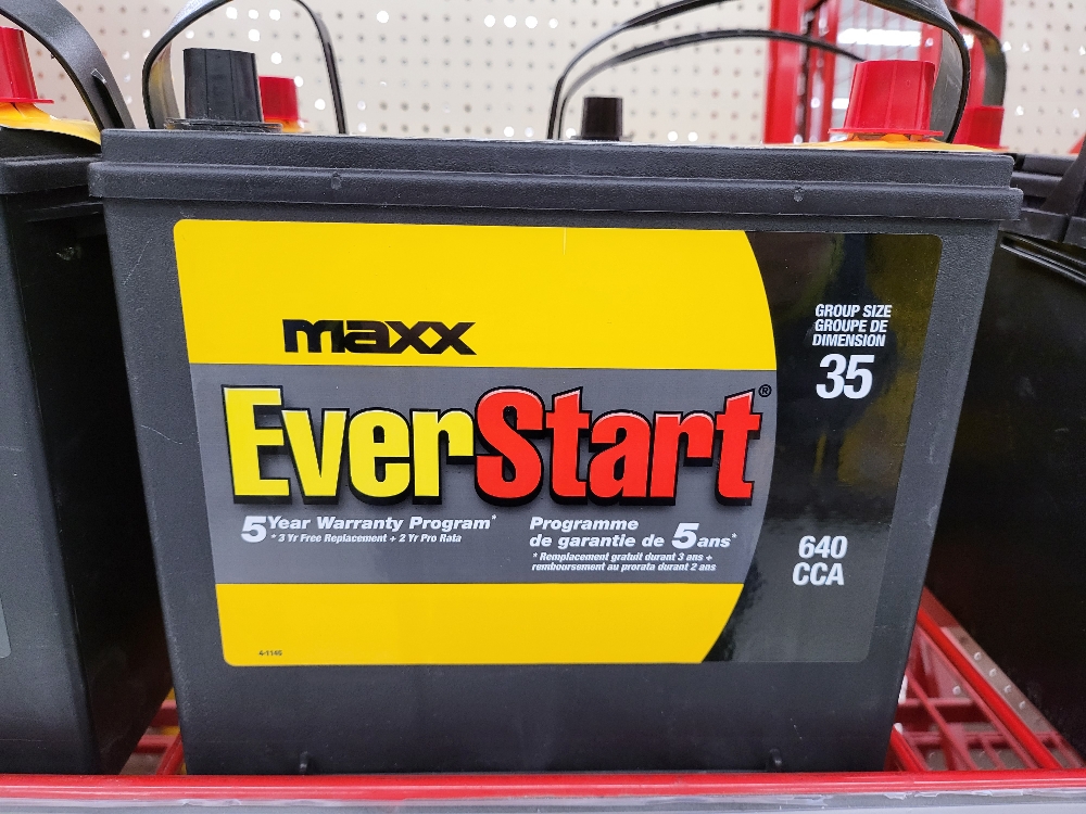

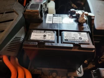

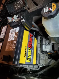

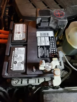

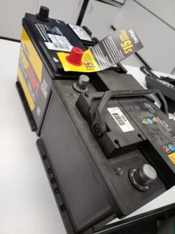

I changed the battery tonight. All I did was pull it. Put it in a Walmart shopping cart and find the best match in the aisle. I went with the one in the photos, I'll look at my receipt for a number but I didn't even know the price until I paid. It was $137 and they charge $15 core which I got back because my gave them the old battery. The battery was about the same size and had the same type of base to clip in perfectly. I could not put back the negative cover and I think I broke it taking it off anyway..lol
