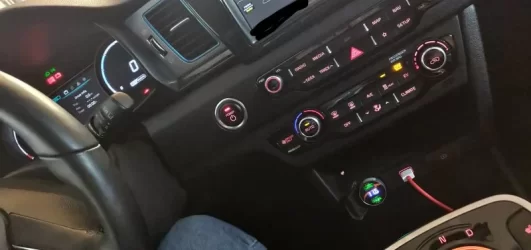

Okay, found it in the cluster settings. It was checked on, but still allows the 12 Volt battery to drain while the vehicle is ON and plugged in (in my case) and verified with a simple cigarette voltmeter. The software will allow the 12 Volt battery to die while the vehicle is ON, plugged in, with significant charge in the HV battery. Unplugging the vehicle after turning the vehicle ON will have no change on the 12V discharge (will not charge 12 V).
The only exception to 12V battery discharge, while plugged in, is during active charging (ie: the HV battery hasn't reached its user set max charge AND within scheduled charge times, if selected). Otherwise, the vehicle will actively discharge the 12 Volt battery while hooked up to the grid and with excess energy stored in the HV battery.

Excellent, yes. I figured that out last night after going through a bunch of hypothetical scenarios on the vehicle (plugged in, on, accessory etc). Also ended up downloading the PDF operator manual after a brief search in the glove box, just to recall the dealership never offered one to begin with (probably accidentally removed at delivery). Thanks!
Unfortunately, I still cannot get the 12 Volt battery to charge while plugged in and ON. I used 120 and 240V, Vehicle ON, or accessory ON....the vehicle will refuse to draw from the grid, while actively draining the 12 Volt.
