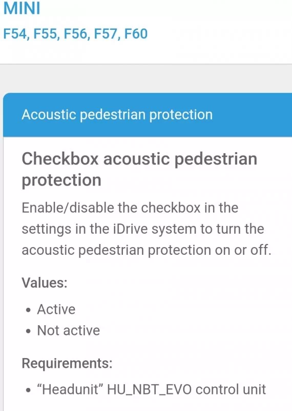

From the BimmerCode documentation, this is what you should be looking for. It's an option to enable the setting. Then you go into the car's settings and there will be a new option to turn off the acoustic pedestrian warning. You can then set this option to be remembered (rather than being on whenever the car is started) through the i3 BimmerCode options as you mentioned
Ahh. Thank you. That's the part that people weren't being clean on. Once you make the change in Bimmercode and "enable" the acoustic pedestrian protection (in the Mini setting) AND make the change in the i3 setting to enable remembering the setting, THEN you go into the car settings and disable the pedestrian warning sound. I was missing the last part of going into the car settings. I thought everything was done in Bimmercode. Once you said "go into the car's settings" it all made sense.
