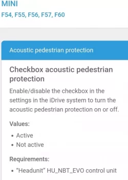

Maybe I'm not seeing the same options as everyone else, but how do you permanently turn off the forward acoustic passenger warning sound? From what I've read you need to login to the app as a mini first to turn it off and then as an i3 to set the permanent option, but when I login as a mini I don't see an "off" option for the forward acoustic passenger warning sound. What am I missing?

From the BimmerCode documentation, this is what you should be looking for. It's an option to enable the setting. Then you go into the car's settings and there will be a new option to turn off the acoustic pedestrian warning. You can then set this option to be remembered (rather than being on whenever the car is started) through the i3 BimmerCode options as you mentioned
