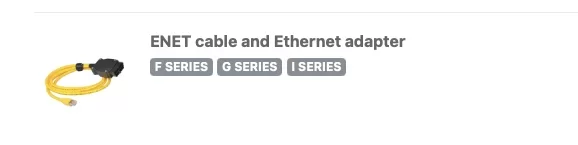

Listed on the https://www.bimmercode.app/adapters/ page.
