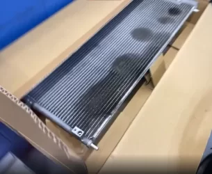

Brought in my 2018 Touring with almost 25k miles for the A/C failing. Sure enough, the condenser was leaking significantly and they replaced it under warranty.
However, now they've identified the system's low and high gauges are too far from normal levels, the cause of which is a blockage in the system, likely the pressure valve. I'm feeling like this should be covered by the extended warranty as well as from what I've found online it seems that blockages tend to occur from leaky/faulty condensers. I'm not a mechanic though, so wondering if anyone else has had a similar experience.

  • Your A/C dies, and they identify the known condenser defect as the cause. It is clearly bad (visually apparent).
  • They replace the condenser only to find that lo and behold there is another problem (unrelated to the condenser failure)?
Let me ask you this - Did you take the car in 'shortly' after the A/C failed, or could you have conceivably been driving around for many months not knowing that all the refrigerant had leaked out? The reason I ask is that without refrigerant, moisture will get into the system [over time] and could cause some corrosion resulting in the valve sticking (or similar). That would not happen quickly, but the trouble is that nobody runs the A/C during the winter, so if the condenser fails and the refrigerant leaks out in the fall, you may not know it until the next summer (hence a 'long' time for peripheral damage to occur).
That would still be the "fault" of the condenser, but seasonal timing could make the difference as to whether additional damage occurs.
If it were me, I would certainly push back. You may get nowhere, but my feeling is that whatever this blockage is, it would not have occurred if the condenser had not failed in the first place. Either that, or you had an incompetent mechanic who somehow caused additional damage during the condenser replacement.
