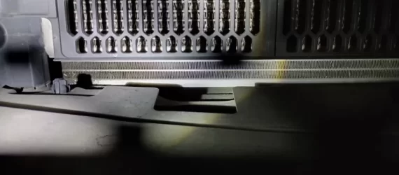

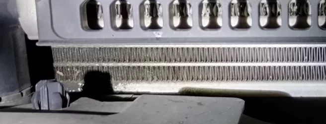

Dirty condenser fins on the passenger side this time, looks like Clarity condenser #2 coming up. Stay tuned...
On a related note, I'm delighted to see how well the new screen I bought & put in (shortly after the previous condenser replacement) protected the delicate condenser fins and tubes behind it.
I noticed in both cases my repair work order (May 12th 2021, today May 23rd 2023) shows installed part number with the suffix of A02, which if I call correctly was supposed to be the later model number. I hope that doesn't mean this later model number is full of condenser duds also...

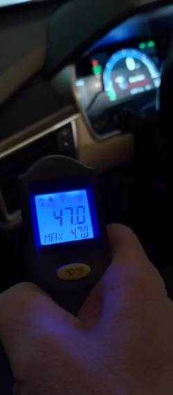

2018 clarity PHEV, ac worked fine until summer 2022, when condenser was replaced twice (under warranty, thanks to this forum). Over winter became suspicious that it was losing cooling/dehumidifier power. Definitely the case now, so sending back to dealer tomorrow.
I had assumed that it would be impossible for *two* replacement condensers to fail, but from the above seems like that does in fact happen. We’ll see. I’ll post a followup once I have a diagnosis.
Thanks also to this forum, I can see that refrigerant pressure is 24 psi at temp 68-77 which is far too low. Nice to be able to check these things.
