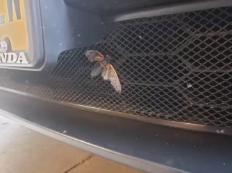

All - here is the Clarity Screen doing its job yesterday! For those of you in the Northeast, the below is what I found after driving into a swarm of Cicada's yesterday near Princeton, NJ. It's not just small rocks we have to worry about hitting the A/C condenser....

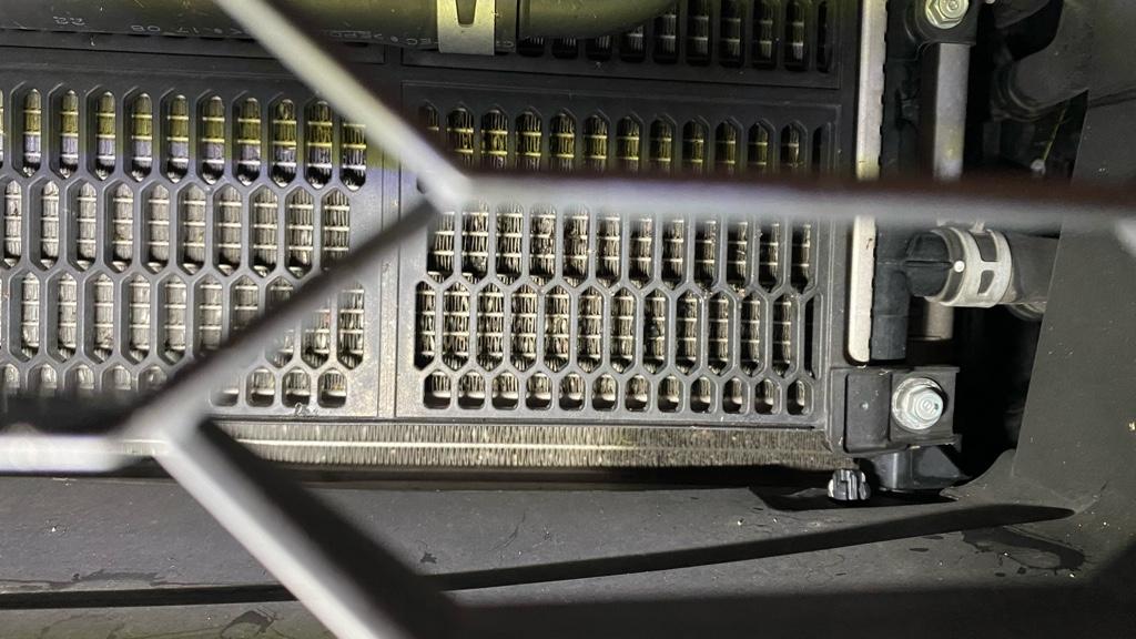

I got down and took a picture of my condenser at 34K miles. I see some small dents from rocks, so I got a screen using the link provided above. Thank you Stephen O’Hara for the quick shipping and reasonable price. Here is some images of the condenser damage. The dirt stuck to oil on the bottom right is concerning and could indicate a Freon leak since Freon carries oil for the A/C compressor. Our A/C still blows cold. Honda did at least put a plastic shield for big stones in front, but it doesn’t cover the bottom and the holes are pretty big. You can see the bent fins from stones in the image below.

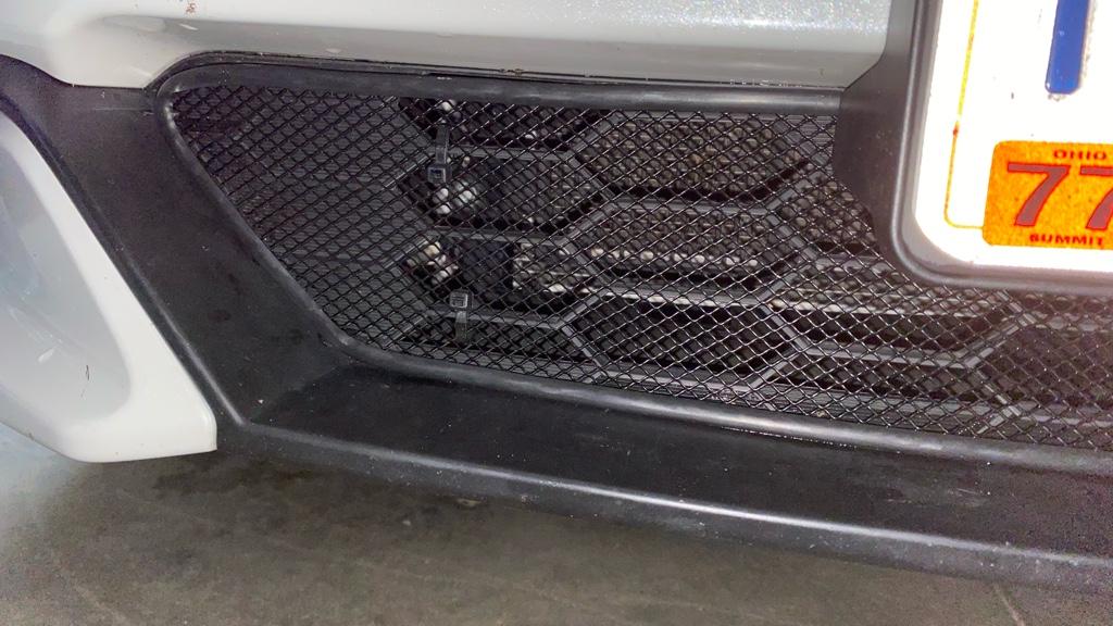

Here is an image of the Clarity screen installed.

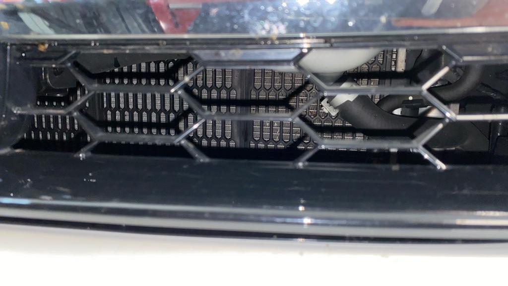

I would think a similar screen for the upper air inlet would be needed, but more rocks will hit the lower air inlet. Upper air let pictured below. You can see some rock damage in this picture too.
I agree that this area is suspicious.
Your eyeball is probably better than the photo conveys, but I don't think this oily area looks like it was caused by a stone.

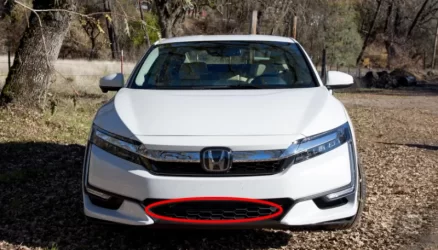

No, it only covers the lower front grille (where the condenser is)...
It is the area identified in this picture...
The other area you identified is probably less vulnerable, and less expensive if damage were to occur. It is quite possible however that the 'voltshelf' guy who makes the screen could also do a smaller one for this other area. The condenser screen is very easily installed with a few zip-ties. I have not looked to see if the other area has readily available attachment points.
Hi fabricated my own screen and had to make a small hole to put a zip tie in to hold it in place. It isn't pretty but it gets the job done. That's plastic welding that you see in various places to reinforce the edges.
