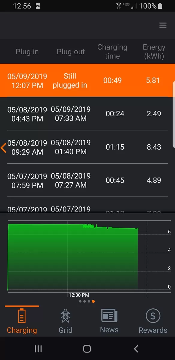

Today was my visit to Honda to address this charging issue. I prepared a three page document with a description of the problem, and I let them know that I know my car quite well, and track it daily with data. I included a few photos of the screenshots from the JuiceBox.

So the attempt is to correct a software charging issue. I'm to drive the car to see if there is a behavior change. The first charge resulted in a good charge graph but the EV Range only reads 43 miles. We'll see what transpires over the next few days.

Didn't work. The charge graph currently being formed shows the same charge anomaly. I'll be setting up a follow up appt. with Honda.

I would be surprised if their charging station gave them this level of visibility. They will quite likely hook it to their charger and declare victory when the car reaches "full" on the EV bar graph. This will neither confirm or deny the specific symptom that you are experiencing.

Hate to keep beating the same drum that JuiceBox and a poster who reposted their comment already made, but I don't see how the JuiceBox could possibly initiate this. The car controls the charging rate (loading on the 240V supplied by the EVSE). The JuiceBox simply supplies the Voltage and a current up to the maximum allowed (either fuse in the EVSE or the circuit breaker). It doesn't alter the voltage or current supplied to the connected load. The connected load is changed by the car.
