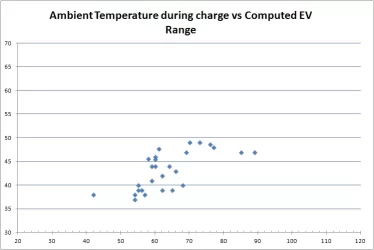

I will add temperature. Actually I was randomly recording temperature and range for a while. That excel file is partly what alerted me to the problem I have with my Clarity. The excel file showed twice the charge reached 48 miles; long before new tires or other indicators.
Unfortunately I wasn't recording the date.
Horizontal is ambient temperature. Vertical is EV Range.
