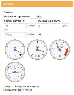

I have a JuiceBox 32 Pro, and when charging, the Status Screen looks like this:
There is a parameter which I have never used (called "Charging Limit (kWh)"). This kind of sounds like it could relate to your "Charging Energy Limit Reached" message... The JuiceBox somehow thought that it had reached a predefined limit while charging. When you hover over this field, there is a pop-up message saying this:
"Set how many kWh to add to car. Value of 0 means no limit". If your Juicebox somehow got a stray entry in this field, it could explain your experience.
At least one mystery solved. There was a 39 mile limit set in the JuiceBox app. This has nothing to do with the original problem, just the more recent problem when the charge cycle quit early.
