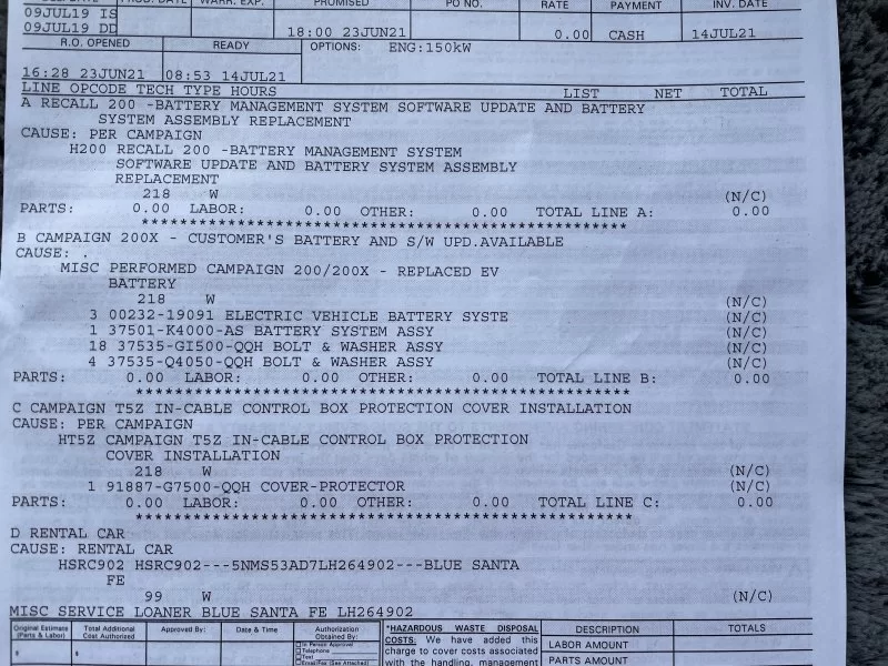

Which connectors did they have to order... or did you mean the 22 mounting bolts?

Not sure. My work order shows:
1 battery
22 bolt and washer assembly
3 electric vehicle battery system (not sure what this part was)
1 gallon of antifreeZe
All I know something “other than the battery” is what took the longest.
sorry I can’t be of more help

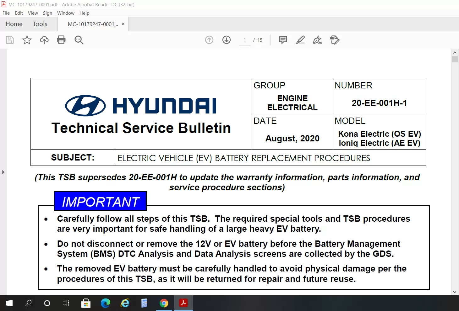

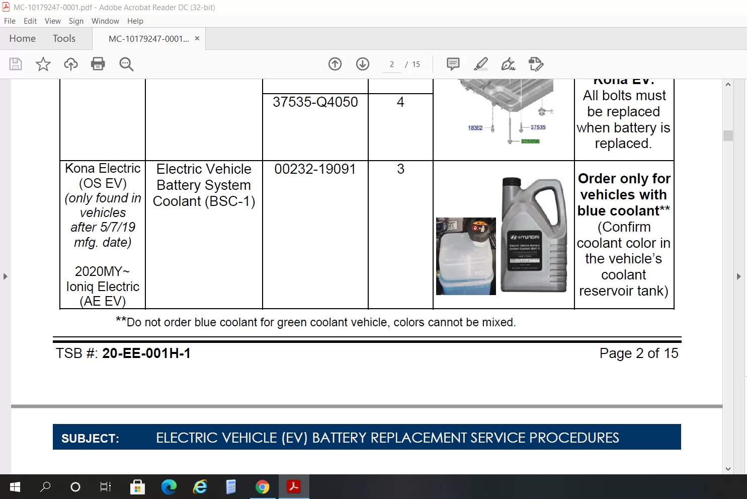

The 3 units of "electric battery syste" 00232-19091 is actually a reference to 3 gallons of coolant.
https://static.nhtsa.gov/odi/tsbs/2020/MC-10179247-0001.pdf

After some digging:
part# 00232-19091 aka "ELECTRIC VEHICLE BATTERY SYSTE"
From the pack replacement TSB:
Is the low conductive blue coolant - in gallons:
and can be purchased for $62.37 USD per gallon - 3 are allotted for this procedure
https://www.hyundaipartsdeal.com/genuine/hyundai-electric-vehicle-battery-syste~00232-19091.html
In your case the color might have been green (depends if your car was manufactured after May 7,2019)
So they probably covered their buts and charged Hyundai for both - antifreeze (if green) or 3 gallons blue coolant (if blue)
The bolts were probably the parts that took longer to receive. (heads up for others owners waiting future replacements- (kindly remind the techs and suppling the part numbers as displayed above should help) - post #108 this thread
