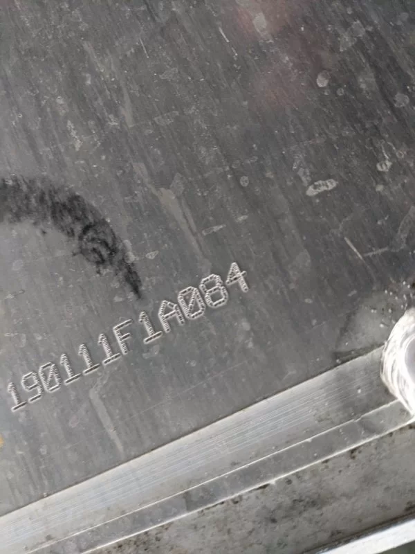

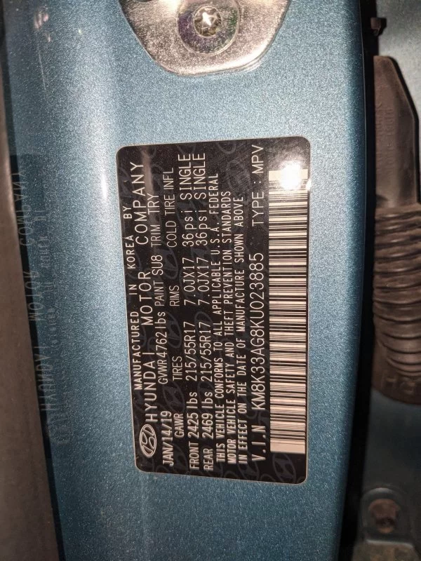

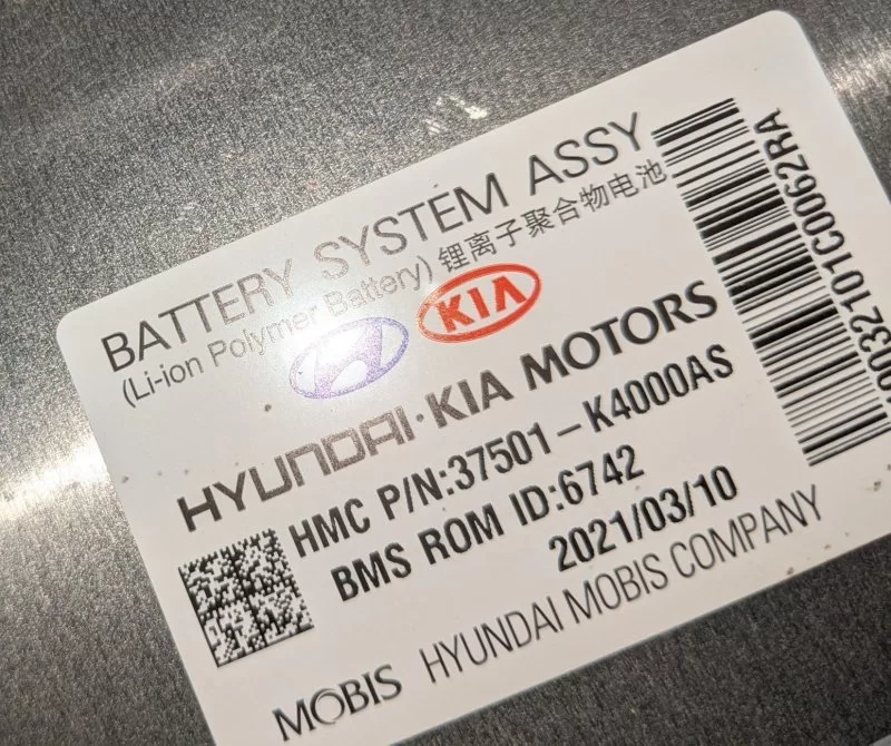

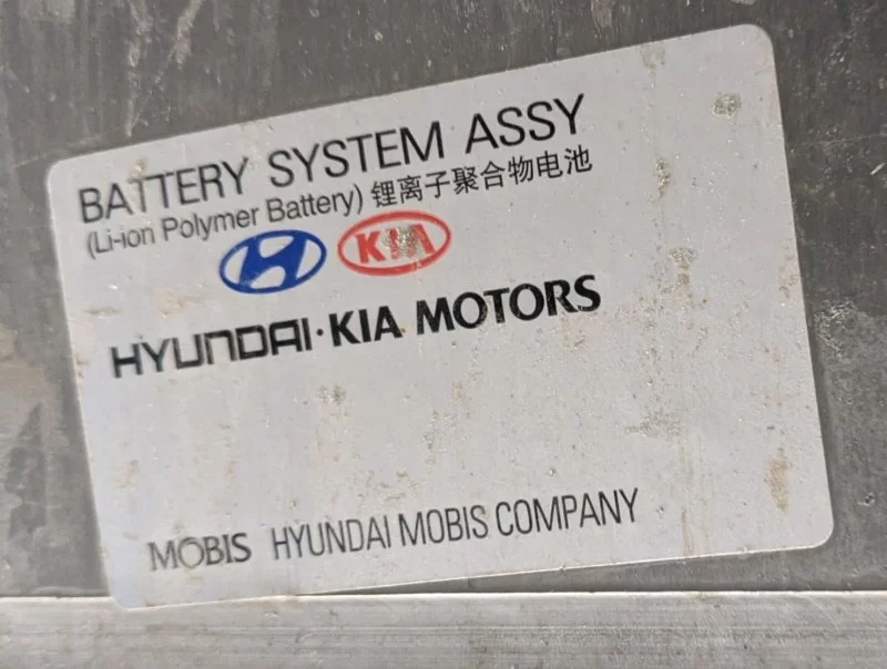

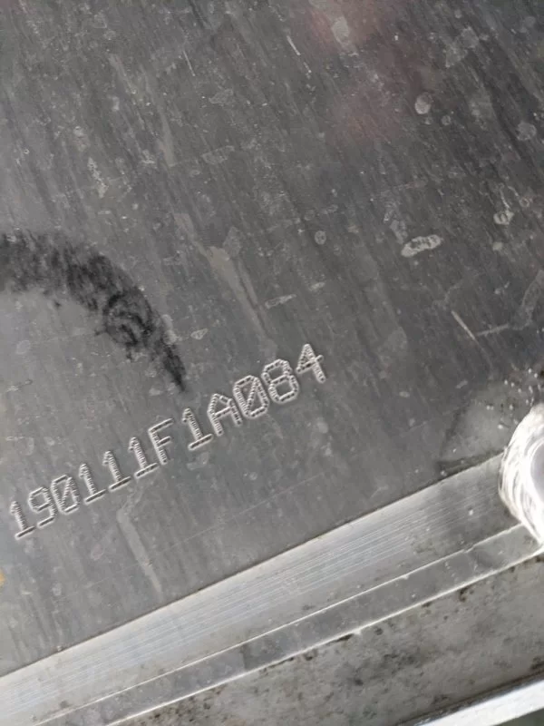

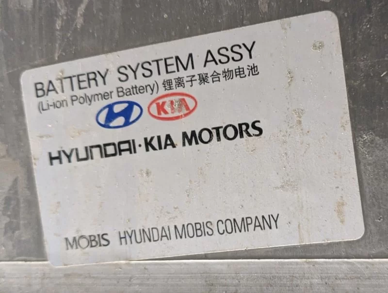

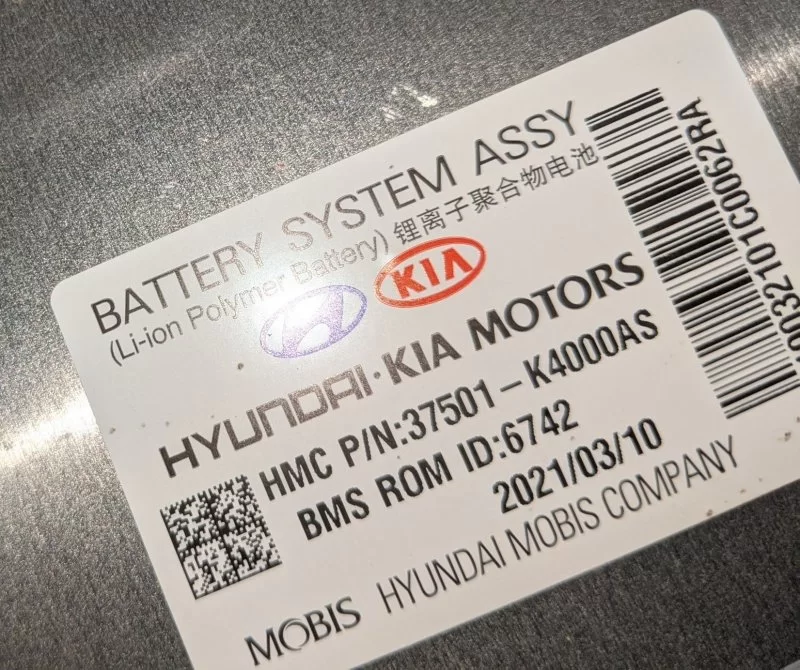

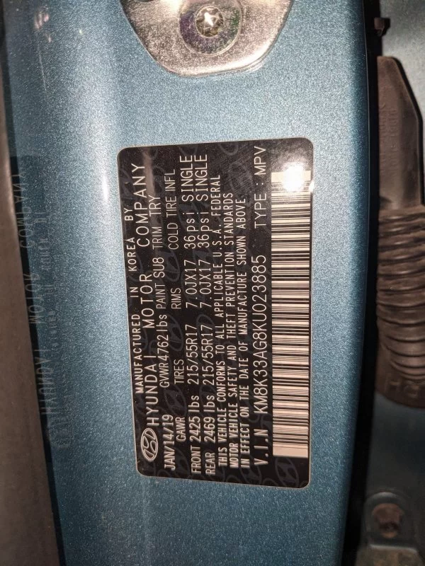

I got my battery replacement done yesterday. The whole process went smoothly, as far as I could tell. The dealer got me a loaner, but they finished in about 6 hours. They said it was their first time doing the battery replacement. New battery charged to 100% overnight, indicated 266 miles of range.
I'll attach photos of the old and new battery labels. For some reason there were no identifying numbers on my old battery label. Maybe lost in two Vermont winters? I did find what looked like a serial number stamped on the old battery. VIN_plate.webp old_battery_stamp.webp old_battery_label.webp new_battery_label.webp
I'll attach photos of the old and new battery labels. For some reason there were no identifying numbers on my old battery label. Maybe lost in two Vermont winters? I did find what looked like a serial number stamped on the old battery.View attachment 12892 View attachment 12891 View attachment 12890 View attachment 12889
So it's July 27th and the battery was manufactured on March 10th. Seems like Hyundai is in no rush. Like we didn't know that already.
