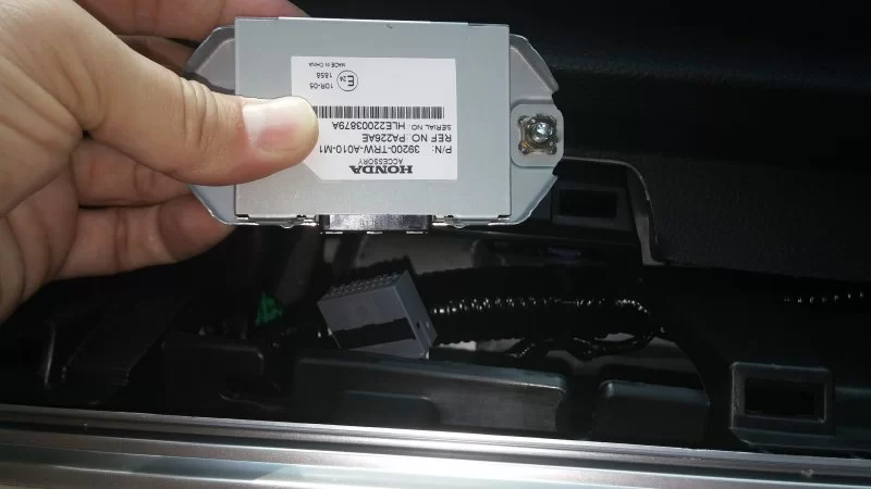

I sincerely hope this is my last entry in this thread for the stereo install. Kentucky was right, it was the ANC. The odd thing that was throwing me was the fact it was tied to engine start and not road noise, or engine noise, as it only did it on the first start per power cycle. Today I went in and unplugged the ANC module. This was actually the easiest thing I have done so far in regards to the stereo install or any mod to the Clarity. The dash panels come off surprisingly easy (I should mention that the "wood" dash trim comes off at a slight out and up angle, maybe 15 or 20 degree, you pop up the front, then pull slightly up and out with them).

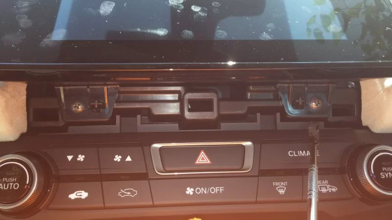

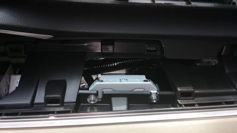

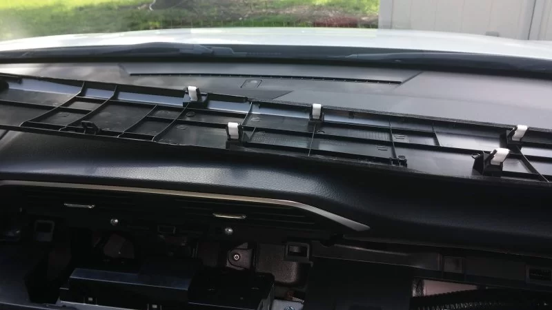

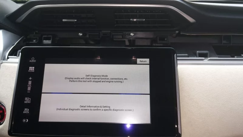

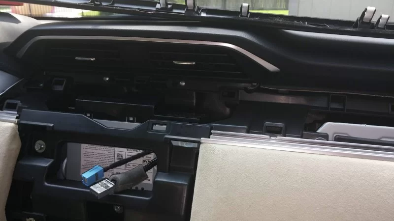

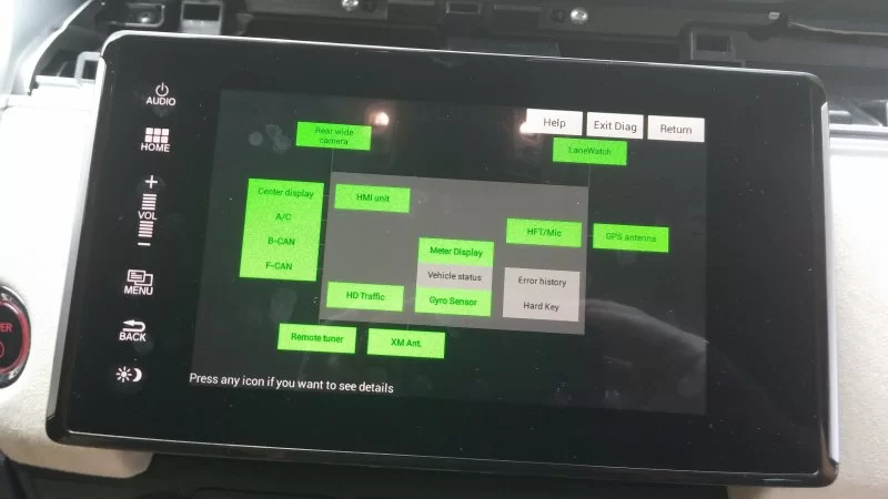

Access was straight forward (once I had access to the visual aids). Now, I am sure I am about to tick off Murphy by saying this and tomorrow the gremlins will return, but so far the BOOM BOOM at ICE initial start is gone. I have photos and info attached for anyone curious and will be happy to answer questions, but it worked and so far no ill effects. My observations were that the ANC does actually reduce a bit of low frequency road and vehicle noise, but not a lot. It does effect sound quality and once disabled I had to "re-tune" the system EQ and amp adjustments, no big deal but was interesting, and really subtle - I'm picky. Honestly I think replacing the tires with touring class that have low road noise and better performance over the low rolling friction high MPG tires that come on it will make a bigger impact on noise cancellation than the ANC system does or did.
Now, probably everyone here will know I can't leave it alone forever. I now have the full wiring schematic for the ANC system including the BUS line for the vehicle speed and engine control system condition data. I suspect it is possible to have the ANC active but remove the engine/vehicle speed data which I also firmly believe was the problem. I never experienced the ANC feedback loop you can get with an aftermarket speaker system - it was only the ICE start. So, since it was very easy to get to the ANC module, I may look into selectively removing the two data pins from the harness I suspect contain the "offending" instruction/commands. If I later get it figured out I will post here. But if it ends up in a Crutchfield Mastersheet I expect a free something from them! :rolleyes:;)
You just unplug the ANC module, secure the harness so it doesn't end up a source of rattle, and put it all back together. It works and I confirmed no major errors using the Infotainment self diagnostics to check the system.

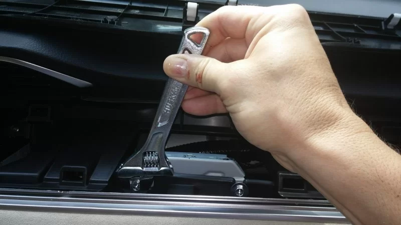

How do you go about removing the infotainment display? There doesn't seem to be any guidance in the post documents. Does it slide right out?

The ANC, at least in my car would create a bass pulse (about 4 of them) anytime the ICE would start up for the first time on a drive or be triggered from the throttle detent. This seems to be a data bus command and not something that the ANC is detecting over the cabin mics as it will happen identically whether driving or parked. It is on my list of things to do when I get some more time to play but the holidays have been very busy. I think it may be possible to suppress this behavior in the ANC module and keep the analog ANC. However, I need to figure out a more objective way of determining the function of the ANC system to determine if it is worth doing so. For now, my upgraded noise cancelling system post sound system upgrade will be a better set of tires that don't generate the road noise the high efficiency ones currently do. I detailed the ANC deactivation in an earlier post above.
Removing the infotainment system is easy, you pop out the little panel under it and the two bolts are exposed. It is very easy to remove after that. The fake wood trim pops up in front and snaps out at a 15-20 degree up angle (up and pull toward you). Sorry it took so long to respond but I have been swamped over the holidays. Final note here is that for those that really read through this whole post and upgrade saga, the Rockville sub (second one) has been working perfectly since the initial failure. I obviously got a dud, but I am not convinced that is not common with them at their build quality. However, for the price I have to say I recommend it as it fits so perfectly, really almost like it was made for that location on the back of the right fold down rear seat. When closed up, you almost don't need any mounts to retain it in place, no rattles at all. So, hopefully it will last a while and I don't blast it like I would in my youth so maybe I will get lucky!
