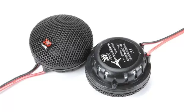

I'm back here with another question. Hopefully it's not a stupid one. After careful consideration, I'm going with the Morel Tempo Ultra 602 components in the front and rear, powered by a JL Class D amp.
My only question is the size of the tweeter. Can someone please advise whether the tweeter from the Morels will fit in current tweeter location?
I think the rear tweeters should not be a problem, just the front because of the shape of the pillar and the cutout for the tweeter itself.
Thanks.

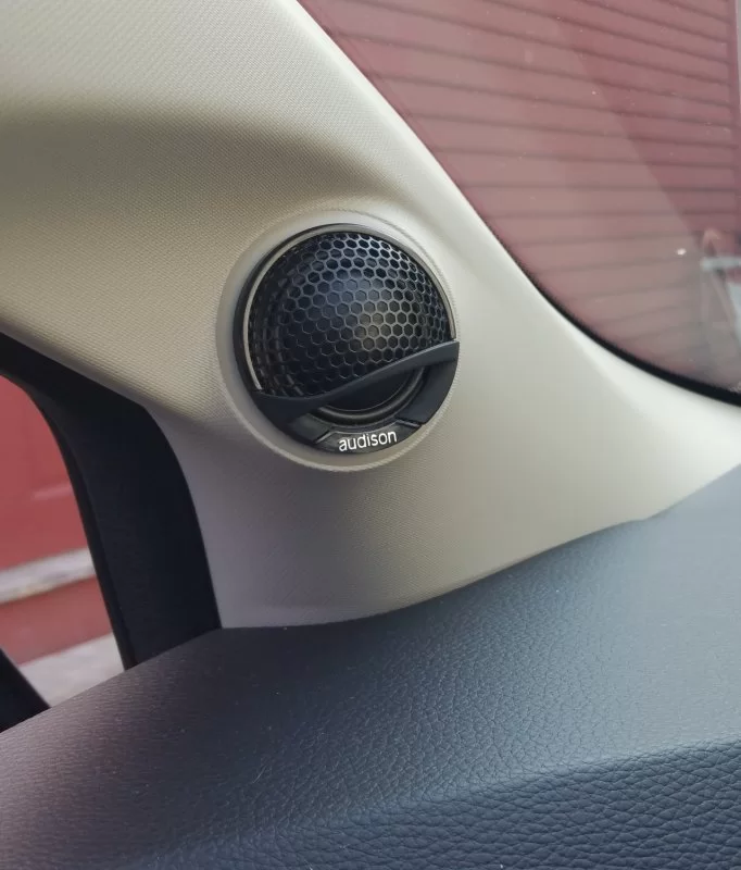

It might depend on what you mean by "will it fit?"
I looked up the specs, and they list the Morel tweeter as "28mm" (just over an inch)
I then looked up the specs on my Audison tweeter, also listed as "28mm"
For the pillar mount, you can see what I did to make it fit. I can't recall if I had to make the hole any bigger, but I don't think so. (I might be confusing it with my Tacoma which I did have to enlarge the hole) I'm pretty sure that "28mm" numebr is pretty standard for sizing. However the Audison would not fit behind the Clarity's own tweeter grill. I think that was the only issue. Looking at images of the Morel, I assume you will need to do the same thing, remove the Clarity's grill and use the Morel grill instead.
To me it really looks like you'll end up with a very similar situation to what I had to do.
My Audison installed;
The Morel Tweeter with built in grill;

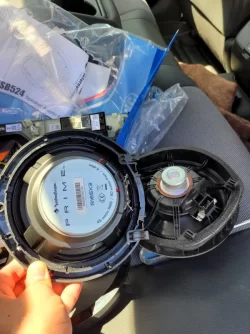

I just installed new speakers in my clarity 2020. Super easy! Just buy plastic pry tools from amazon and buy speakers from Crutchfield by typing in that you have a clarity as a car.
Bought 2 pairs of Rockford fosgate component speakers (3 way speakers ). 100$ Canadian dollars. Crutchfield gives you the wiring harness and also adapter rings. Took me an hour for the first door since it was my first time doing this. Had to cut all the little plastic ridges inside the rings. Just took a little reciprocating saw blade and cut them by hand. Crutchfield also supplies a picture by picture guide for removal of door panels. So maybe 40 minutes of work for the other 3 doors.
The sound is much better! Crispier sound and bass is more precise and less muddy. Cleaner vocals too.
Just look at the picture of the difference in the magnet at the back of the speakers
