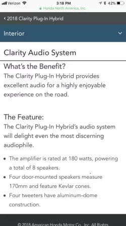

I think the sounds from the speakers are a little muddy. If the 6.5 speakers are woofers, would it sound better if I upgrade them to 2 way speakers? Would that make vocals sound better? I can hear vibrations from my driver's front door when playing music with some bass. Definitely need sound proofing material.
Maybe, maybe not. If the factory system is wired with a crossover that limits frequencies to the woofer, you won't gain much by installing 2 way drivers in the door. If there is no crossover (and the tweeter is just protected from the lows by a simple capacitor), then a 2 way might add some high frequencies. However, maybe too much, because that would mean 2 tweeters in the system. The tweeters really handle only the highest frequencies. You'll likely (but YMMV) improve the perceived muddled sound the most by simply installing better woofers in the doors. And, as usual, those will sound even better if matched to an appropriate tweeter. Someone is going to need to delve much further into the sound system to see if there is OEM crossover and where it is. If the factory amp contains crossover electronics, it may be a challenge to get much improvement in sound without a processor. In the end, I'm going to "guess" the factory sound is very simple, with just a capacitor protecting the tweeters and otherwise full frequencies going to all 8 drivers. I have a pair of Infinity Kappa component speakers just sitting around, so when I get time I'll do some experimenting (probably not until this fall, though).
This is good analysis. Honda typically does the simple things... Full range to the woofers and capacitors on the tweeter. Both the current generation Civic and crv are wired this way.
