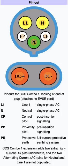

The J1772 Connector does not have the pinouts for 3-phase, so regardless of how the electricity is wired to the EVSE there's no chance of it going into the car.

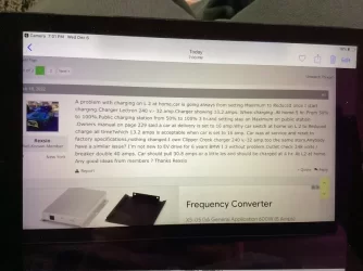

A problem with charging on L 2 at home,car is going always from setting Maximum to Reduced once I start charging.Charger Lectron 240 v.- 32 amp.Charger showing 13.2 amps. When charging .At home 5 hr. From 50% to 100%.Public charging station from 50% to 100% 3 hr.and setting stay on Maximum on public station .Owners manual on page 229 said a car at delivery is set to 16 amp.Why car switch at home on L 2 to Reduced charge all time?which 13.2 amps is acceptable when car is set to 16 amp. Car was at service and reset to factory specifications,nothing changed.I own Clipper Creek charger 240 v.-32 amp.too the same story.Anybody have a similar issue? I’m not new to EV drive for 6 years BMW I 3 without problem.Outlet check 248 volts / breaker double 40 amps. Car should pull 30.8 amps.or a little les and should be charged at 4 hr. At L2 at home. Any good ideas from members ? Thanks Rexsio

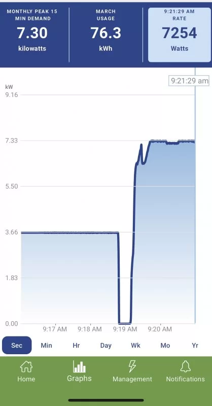

I would suggest monitoring the line voltage. The car might step down the charging rate if the voltage is too high/low. Remember that the car is doing the AC to DC conversion.
Thank you for that suggestion which solve my problem Rexio
I live in Oz (240v), and have a Tesla gen 3 charger. My 2020 SE always charges to 100%, and takes a little over 4 hours from 10ish to 100%. This is 7.4 kW. Just confirming that your neighbour's charger went to 7.4 when connected to your MINI.
