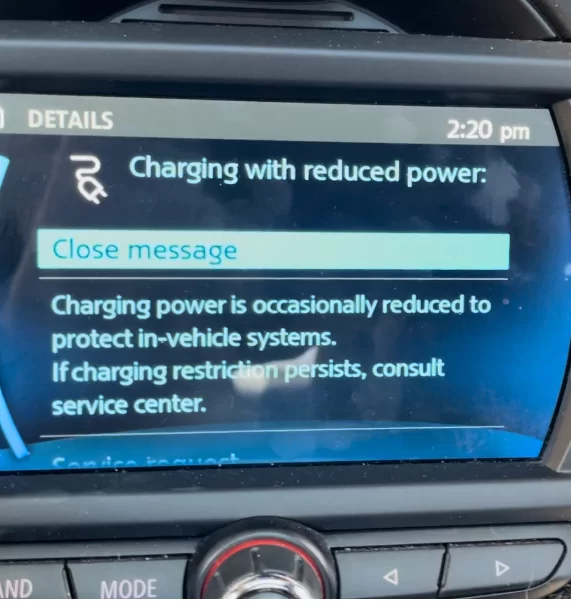

I would suggest monitoring the line voltage. The car might step down the charging rate if the voltage is too high/low. Remember that the car is doing the AC to DC conversion.
The Wallbox support team had the same idea and downloaded the logs from my unit. Line voltage going in is fine. I’ve also got a load management unit that will cut the power to the EV charger if the overall house load is approaching a certain capacity (eg hot summer evening with oven and AC on). My understanding is that unit is “all or nothing” though and couldn’t reduce the Kw from the normal 7.1 to 3.8 as is happening with me. It cuts out the EV circuit completely until household load drops back to a percentage of maximum.
The other thing I asked Wallbox was if the car was telling the unit to reduce the output. They said there’s no comms between car and power delivery device for L2 - only L3 DC fast charge mode. For L2 all the power is available and the car decides how much to take - either because the charge settings are reduced or as apparently in my case…the damn Mini is haunted….
