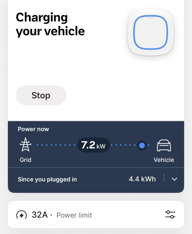

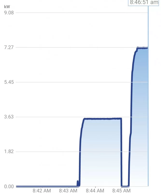

Yes my Mini does this exact thing. Come home, plug in, get very long estimate to charge up. Then in about 10-15 seconds get Reduced Charging message.
Then I stop the charge (either in Mini Menu, L2 Menu, house circuit breaker, or just pull the connector off the car.)
Then I reconnect the car to start the charge again and the error message goes away and the car’s estimate to charge up is much quicker indicating the onboard system is using the normal higher power.
My L2 unit has an app that shows what it is doing. Here is a screen shot two sessions. First one, only ~3.6kW15amp then the next session after I restart ~7.2kW/32amp.

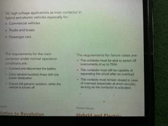

At list is 2 of as as proof is something wrong with SE and we are not crazy but a dealer is not going to take care of this once they can’t replicate conditions in their dealers shops .I’m not electrician with degree of engineering but I reaserch a lot and in my opinion contactor in onboard SE charger is overacting taking charge AC from home wall charger convert to DC and if any spike in voltage occurs is closing flow of voltage to a car .at least is doing correct job.Those devices contactors react in nanoseconds to prevent damage to a car that’s why reduce charging occurs.This is not right Bmw should take this to consideration before **** happen and some of SE’s start burning our garages/ homes .I introduce my problem to geniuses from BMW concierge relations over a phone and I was not able to get phone / email to engineering BMW group from BMW headquarters to talk to someone knowledgeable to introduce my concern.
