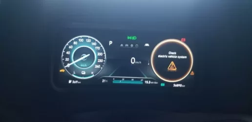

After charging my 2022 Kona ev, I went to start it and I recieved this error. "Check Electric Vehicle system "
Used my battery booster, tried jumper cables, tried unplugging the positive connector of battery. No luck.
Car is being towed to dealership now.
Bought it in September 2021 and have put on about 37,000 km. Never had a issue until now.
Hopefully something small, but will see.
