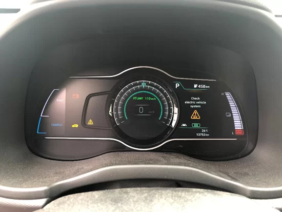

Are you the owner of a 2021 or 2022 Kona Electric who has gotten this message on their dash?
If so, please respond and post. Basically, I am trying to find out how widespread this issue is.
I received the message about 3 months after buying my 2021 Kona Electric (13000km). It stopped my car from moving and had to be taken to the dealership for a battery replacement. The dealership did a full investigation of the BMS (took about a week) and the result was I needed a entire traction battery replacement. So, it has been 7 weeks and I am still waiting with no end in site.
If you are in a similar circumstance, please come forward and post. I have seen several posts on this forum already from other users and encourage them to tell their stories.

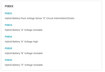

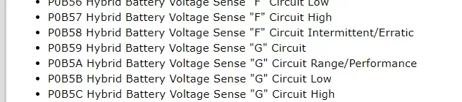

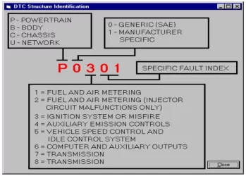

Just did a quick search of OBD2 codes. Your code looks funny. Not an OBD2 expert at all, but I think that the last 2 digits are "hex" codes. Perhaps your reader is out of date and the actual code is "P0B59"
It seems to me that P0BXX codes are reserved for electric/hybrid vehicles. Not sure how "compliant" or "standard" the codes are across makes and models but I did find this....It definitely doesn't list your code as provided, but does list P0B59, and some of the codes in that list look concerning. You might want to get that checked out.
Here is a link to where I found the codes.
https://www.obd-codes.com/p0b-codes

I just looked this up in the DTC list I got from hyundaitechinfo site, and it *is* listed as P0B5900:
battery voltage sense 'G' circuit. Maybe the trailing 00 is a sub-code or something. To me, that
implies something amiss with the BMS sensing circuit itself, not necessarily the condition of
a cell block. Which might still need opening up the pack to fix... not fun.

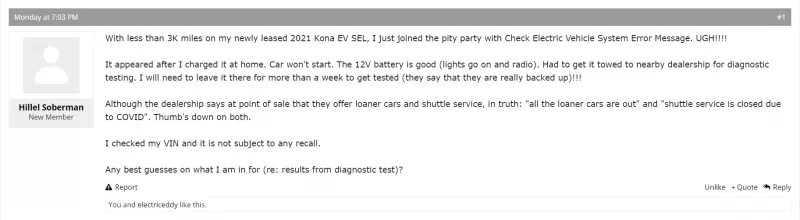

Joined forum today to report my March 2020 Kona has joined the "Check Electric Vehicle System" failure club. Actually for the second time. First time in a Car Park 2 months ago on an AC charger, I pulled the cable and it come out whilst the power was still on charger, so found video on-line and reset by pulling 12v battery and all worked OK and I put it down to EMI issue with hot switching the charger.
Today Kona was in the garage on Home charger to 100% overnight (as travelling long distance) and disconnected and found CEVS messaage on dash. Thought I knew what to expect, i.e. no drive, which was right, but disconnecting and reconnecting 12V battery did not clear the fault. (tried 3 times!). So out comes AA man (disguised as Hyundai Assisstance) scratches around nothing happening. Then he gets he ODB Bosch(?) reader and plugs it in the port. Sucks out all the data and hay presto Kona clears the CEVS message and we are off.
Interesting while I was on test drive AA man looks at OBD data and finds a fault still active message ?? So he's emailed me the data (should get it in a couple of days) So now I'm booked in to main dealer 5 days away, are they going to take may car away for 2 months? What's the issue really? Are all the batteries dud?
Will be only charging to 90% in the meantime!

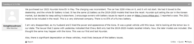

I have (had) a 2021 that started popping the “check EV system” and was able to clear it a few times, both at the dealership and by myself. Dealer eventually told me the car had to stay and has now been on their lot for nearly 2.5 months with no information forthcoming other than it needs a new battery. I’m a pretty patient person and understand that things break but the lack of information has been testing me, how long is it acceptable to have my new car? I hope your situation doesn’t end up like mine!
My 2021 Kona EV has been dead at the dealer since August 15th. I had it for 2 months - Hyundai has now had it longer than I have. Really sick of making payments, insuring it. Waiting on offer from Sedgwick at this point.

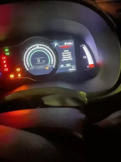

Hi, another user with the ‘Check Electric Vehicle System’ here. After a while this changed to ‘Check 12V battery’.
This was after a 300 mile journey with two rapid charges. I unplugged the Kona from the rapid charger last night and got this message. The car had stopped charging at 91%. After coming back to it after five hours it started immediately with no error!
I now have the return journey tomorrow and am apprehensive as I will need to rapid charge once.
Any advise is welcome! I guess the first thing is to knock the maximum charge down to 90%?
