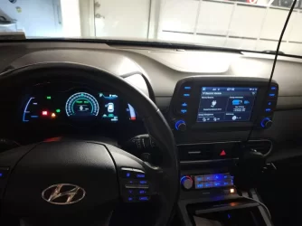

Happened again for the 3rd time. I have been charging 100% but only gave me 80% this time. Called hyundai but they do not have open schedule to work on my car till december or some thing... that is some BS.
My car just bricked this morning after charging to 100%. Got the, check electric vehicle system alert. Tried to remove the positive battery post to clear error and it did not work. I called my dealer’s service center at 10 this morning and two additional follow ups, sent to service manager’s voicemail each time. They closed at 4pm and didn’t bother to even call me back. Really ticked off with the customer service and concerned about the car. Will update as I get news.

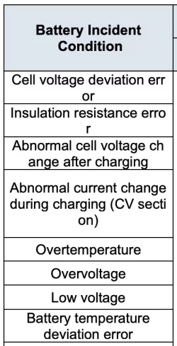

Thanks for posting that TSB as it's the first time I've seen it. Included is a list of items the BMS is checking, especially during and after charging. Many of those can be checked using the Car Scanner app on a smartphone. It appears that the service tech has to figure out which is the problem and take the action indicated, most of which are to replace the entire battery pack.
It's seems inevitable that battery pack designs will evolve to being easier to repair by the dealer in-situ. Manufacturers can't continue to eat the cost of an entire pack every time one part of hundreds is out of spec.
* CV means constant voltage, I believe the latter part of charging curve, when approaching 100%.
