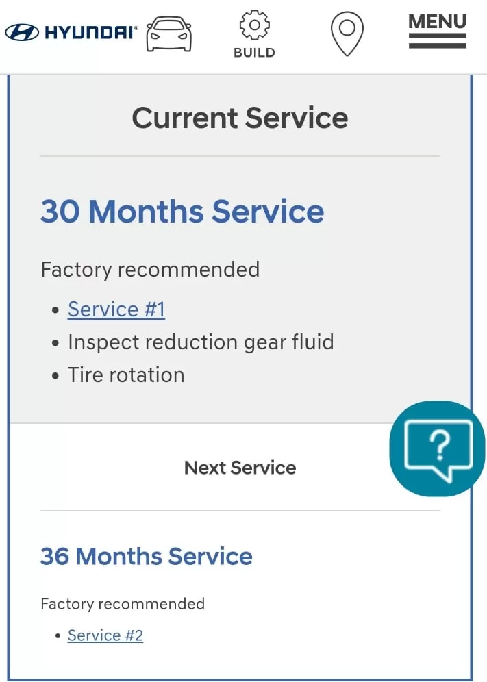

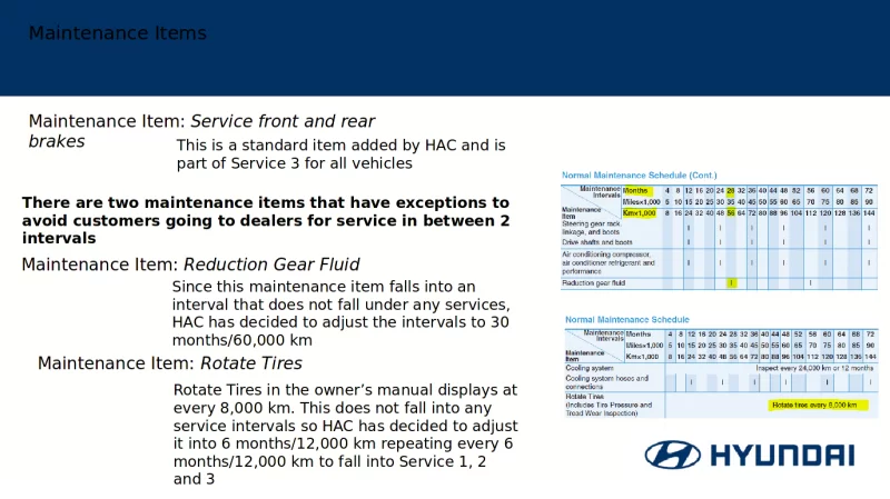

From what I understand, this was updated direction from Hyundai. It was just supposed to be an inspection but it was dirty so it needed to be replaced. When I check the Hyundai website it says 30 month check as well for my 2019.
Sent from my SM-G960W using Tapatalk
That's weird. I literally am looking at the maintenance schedule on the Hyundai website for a 2019 Kona EV and it not only doesn't mention the reduction gear until 120,000km it doesn't even HAVE the 30 month interval that yours is showing!! What the what??
Edit* wait, it does say inspect at 60k.
So it was 120k originally and now it's 30 months? And at 30 months I have only 35k kilometres but I might need a fluid replacement? That's a pretty big revision. And one that's potentially 4x more expensive. What did they charge you? I'd heard it's about $150.
I understand "inspect" to mean check the level. Perhaps a diligent technician took a sample as well?
Yes but it seems that these "inspections" are leading to the discovery of goop and goop is leading to (potential) fluid changes and at a rate 2, 3 or 4 times more frequently than originally suggested.
I suspect that only first early reduction fluid change is recommended due to break in period generating more metallic debris.
And all subsequent changes are most likely good to be done on normal schedule.

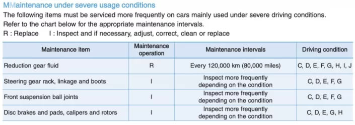

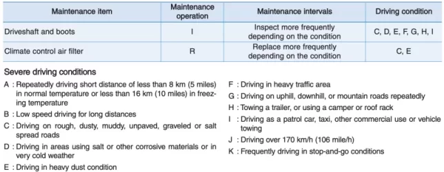

There was always a fine print in Europe if car is driven in severe conditions that maintenance intervals for some of the items can be halved.
My copy of the Canadian manual says that the maintenance cycle defaults to "severe conditions" so any tightening of service intervals would be even more severe. It's feeling like a bait and switch situation.

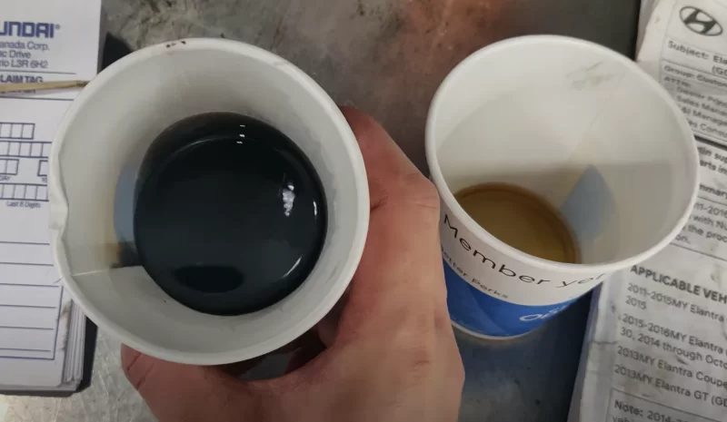

"Goop" is not really what you'd find with a small sample, noting how it appears clear but darkish while draining in the post #24 video. But when placed in a clear bottle the discolouration is obvious. Every Kona's gearbox oil will look at least as bad as this after 20,000 km. This one shown at 40,000 km is horrific, frame grab below.
I'm all for scientific evidence-based conclusions rather than speculation, but ignoring that for a moment in the interest of expediency, I'm starting to think that this is the cause of the gearbox noise issues - conveniently the subject of this thread and multiple others. From a statistical perspective I'd have to image the chances of having two major design screw-ups so close together would be rare, so it may be just this one issue alone, the omission of a magnet.
I can see how added bearing drag due to ingesting break-in wear particles could result in outer race spin and subsequent wear of it's aluminium housing resulting in loading the motor splines, making a clunking noise and wearing them. It's all entirely plausible. I've suggested to those in our local FB group (in NZ) that their oil should be changed at the first service at their own expense.

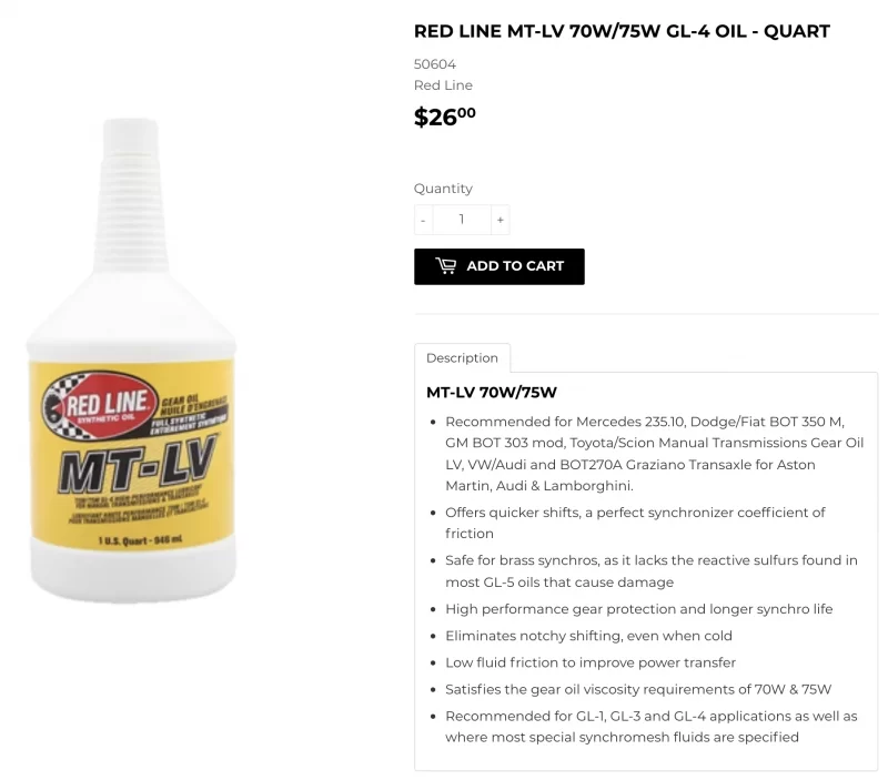

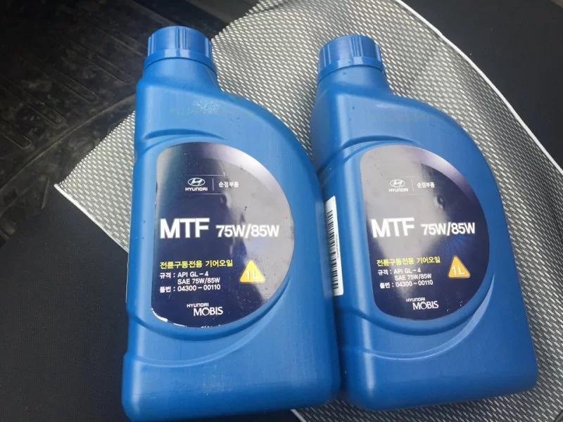

I wonder if they used a 75W85 because it was the thinnest GL-4 they had readily available? The spec for the Kona is 70W, which has a viscosity similar to ATF.
In the owner's manual it's stated as "70W, API GL-4, TCGO-9(MS517-14)." The latter "MS" spec is 75W according to Google. Redline has a MT-LV 70W/75W which seems ideal for DIY. Further searching revealed that Redline recommend it as well.

Use the Redline since you can get it. I think Walmart gave me a ship-it-here price. More realistically:
Use the Redline since you can get it. It's $47 a quart here and has to be shipped from Auckland so I'm using an Australian 70W-75W GL-4 at about $39 /L.
Holy cr**, it's even more expensive in Canada, $53! I'd shop around perhaps. It needs a bit over 1 L so you'll need 2 bottles. The dealer is the other option.
