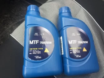

I wonder if they used a 75W85 because it was the thinnest GL-4 they had readily available? The spec for the Kona is 70W, which has a viscosity similar to ATF.
In the owner's manual it's stated as "70W, API GL-4, TCGO-9(MS517-14)." The latter "MS" spec is 75W according to Google. Redline has a MT-LV 70W/75W which seems ideal for DIY. Further searching revealed that Redline recommend it as well.

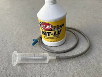

I procured the appropriate Redline MT-LV replacement oil for the gearbox and decided to change it today at 3 years and merely 19,000 km. Here's a video of the oil being drained and then poured into a container. The latter half is edited to a reduced framerate to make it easier to see that the fluid is free of metal debris, despite being darker than I would have expected.

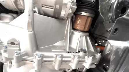

Would it be possible to show the refill (which plug to remove after the drain one is reinstalled and quantity )
Is there a way to check the level after completion?

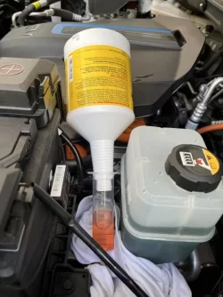

Spec says 1 litre but 1 quart (946 ml) of oil was sufficient while the car was on ramps but I think I'll lift the rear with floor jacks tomorrow to level it better and try to add a bit more. You fill through the filler plug until it overflows like any diff or transfer case.
The plugs are a 24mm hex and have aluminium washers. A socket and 1/2" ratchet drive do the job nicely.
The Redline MT-LV is very thin, just like the original oil. No doubt anything thicker would reduce efficiency. I suspect the gearbox interior has a magnet as there was no magnet on the drain plug and I'd have expected some minor metallic debris, yet there was none.
Just as an aside, where do you get that little measuring cup dispenser? I could use one of those for other applications.
It's a large syringe with the plunger removed. An auto parts shop should stock that.

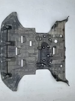

How on Earth is your undercarriage so clean?!

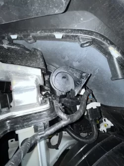

The drivetrain was cleaner than I thought it would be but the top surface of the plastic cover not so much. But what surprised me is that there's a low-tone horn down there. The high-tone one is located next to the heat pump valves, up top. I wonder why they're in two different places?
Ahh, yeah, thought the shape looked familiar. Thanks, attaching that hose outlet helps to get into tight and awkward locations.
The reason I used this method instead of a pump from underneath is that the 1 qt oil container was slightly less than the 1 litre gearbox capacity and I couldn't afford to lose any. However, as it goes I still spilled more than I should have.
Now that it's almost done I'll add that this job can't be easily done with ramps as I have used. The angle is too great to get the gearbox oil level high enough because the filler opening is at at the far-rear end. I ended up jacking the car up at the rear to nearly the same level as the front, where it took another 150 ml.
The closest option might be to just jack the left side of the car up, but it's clear that using a lift is really a far better method.

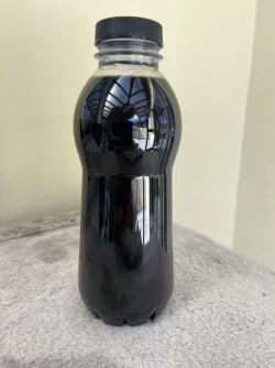

Thinking about this while I cleaned and reassembled the underside panels, I’ve decided that the cleanliness of the oil is unacceptable for the low kms, only 19,000. I even wondered if it was due to an electrical discharge.
Carefully watching the disassembly video posted last year, I can see that there is no magnet installed in the sump. But there is a carbon brush at the motor output shaft to ground any stray currents.
So, I’m concluding that it’s the most obvious reason.
Splash-lubricated gearboxes should always have a magnet secured somewhere to collect ferrous debris shed from the gears, otherwise it continuously accompanies the oil as it does its job. The gears don’t care but rolling element bearings will suffer completely unnecessary wear.
This is why the oil is dark and there are no slivers of steel present- they’ve been ground up to particles so small that they stay suspended in the oil. I was able to pull some out with a magnet however, so I’m convinced that my conclusion is correct. The should still be golden brown at so few kms, with visible slivers of steel stuck to a magnet.
Whether this is problematic within the service life of the Kona is hard to predict but I’ll be changing the oil about every 20-30 thousand kms from now on.
I thought after watching your video but before reading following posts that the oil appeared to be holding stuff in suspension, so I agree with your analysis.

I'd be surprised if only an oil change could have reduced or eliminated the noise but you could be lucky. This is what mine looked like after 3 years 19,000 km and I didn't have any noise. There is nothing unexpected here given that Hyundai have not bothered to include the all-important magnet to collect ferrous debris.
