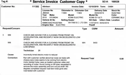

I don't think there is an official TSB yet - but after doing some more research it boils down to 2 possible fixes/solutions:
1. Drive shaft assembly rotation by 180 degrees (I've attached an actual work order of a Kona driver who claimed it fixed his issue)
2. Complete Traction Motor Assembly replacement (Electric motor, drive gear & motor assembly) 36500-0E701 or 36500-0E702 (newest model)
https://www.hyundaioempartsdirect.c...or-assembly-365000e702?c=cT0zNjUwMC0wRTcwMQ==
I'm not sure if I'm willing to try option 1 first - with limited success if done properly - and I'm worried about existing damage to the assembly - as any noise coming out of there must be wearing something down and doing some harm.

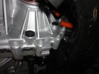

Here's an example from the UK. My Kona Electric was delivered in March 2019, so similar vintage. I too heard the dreaded clicking/pattering noise about 6 months into ownership. I knew what it was, having read about the problem on a Kona forum. It was very brief and disappeared. It resurfaced about a year later and continued to happen intermittently. It was always at less than 35km/hr. Above that it was quiet. Spring/summer this year, I started getting harshness
at higher speeds which you could "switch" on or off by applying power or easing off. This was gradually getting louder and the clicking/pattering was now very very obvious and predictable. At this point, I was sure that the Hyundai dealer could not ignore it, so took it in to be checked. They confirmed the noise and ordered a new traction motor. It took about 4 weeks to receive and fit the motor. They tried to get around their technical problems by leaving me in the dark but as I pestered them about what the issue was, they admitted that the new motor had not fixed the problem and they had been advised by Hyundai UK that it would need a new transmission which they had duly ordered. Three weeks later the car was returned with shiny new drive machinery (latest motor, serial number .....702) and without the dreaded noise.
As others have suggested, the problem is most likely a slight misalignment of the motor drive spline inside the gearbox input shaft and that a long period of running in this condition had probably damaged both components. It seems a bit drastic to replace the entire reduction box and differential assembly, but I am not complaining (apart from having to drive an ICE Mini for several weeks, that is). Hyundai have told me officially that my Kona is also due for a new battery, although there are rumours that this may not happen (in the UK, at least).
Thanks for that report. I hate the back and forth, so I think I may delay this issue a bit longer, until it's more obvious. Currently just a faint clicking (very much like the recording that mdsweb posted above).
Where the noise is still subtle and dealer help is not imminent, to be proactive it would not hurt to check the cleanliness of the gear reducer oil. I haven't done this personally but it would be a matter of opening the filler plug and inserting a Q-tip or similar inside to take a sample. There have been several cases of very dirty oil, indicative of excess wear, but this is not noticed until things completely fail. The oil type is just a common straight 70 weight GL4.
I think this photo is from hobbit's site, hopefully he won't mind.
If your dealer is uncertain how to proceed ask them to contact HYTAC(Hyundai's technical assistance advisors) They have definitely dealt with this problem before.
