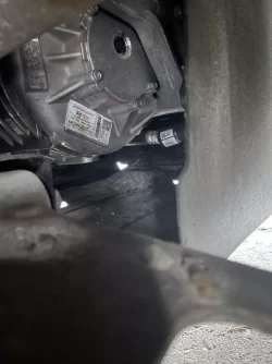

My car was in for the main battery replacement this week. I asked for the oil in the reduction gearbox to be changed and for the used oil to be returned to me. I shook the used oil vigourously and poured a sample into a ziploc container. This is a single weight (SAE 70W) GL-4. It has blackened for sure but I see no sign of metal particles with an inspection light shining through it and I do not have the wheel-of-fortune noise. Mine is a Dec. 2018 build with 18K km.
There are no obvious visible particles because they have been circulating continuously and by now are ground down to dust, making the oil black. You will be able to tease out some of that dust with a magnet as I've done here at 19,000 km. Larger particles are what you want to see but caught by a magnet before they've had the chance to damage the bearings.
The example I've shown in the image above took hours to achieve with a strong magnet. Dust-sized particles are not highly attracted to a magnetic field. But larger particles freshly shed off the gears will stick to a magnet when they are very close by.
I wish all owners would take the advice because every example will have black oil in it.
