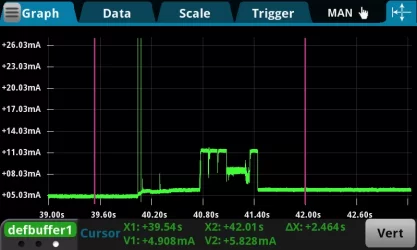

Thank you for your efforts, most interesting reading. You inspired me to look more closely at my 2019 Ioniq electric 12V system. Ioniq electric owners are having the same, or similar 12V problems. Same as you, I am curious, but have had no 12V problems yet myself.
I am about to take some data with a DC split core current transformer (10 us, 50A, 4-20 mA loop) and Keithley 6500 digitizer, no idea yet if anything interesting or meaningful will show. May I post some ioniq electric results here, or would you prefer that I start a new 12V thread in the Ioniq electric forum?
Thank you for your efforts, most interesting reading. You inspired me to look more closely at my 2019 Ioniq electric 12V system. Ioniq electric owners are having the same, or similar 12V problems. <snip> May I post some ioniq electric results here, or would you prefer that I start a new 12V thread in the Ioniq electric forum?
Please post here, and can you give us a link to the Ioniq forum discussion(s)? Maybe we can get this all in one thread, so all of us with the same problem are talking with each other.
I'd sure like to see any results either here in this thread or as a link to an Ioniq thread. I have no easy access to such useful kit. Formulating a test plan that will identify the fault(s) is the challenge. Do you have BlueLink app capability on your Ioniq?
Thank you, I think a collaboration would be good. No links as such to the other forum, at the Ioniq electric forum (https://www.ioniqforum.com/forums/hyundai-ioniq-electric-ev.234/) there are any number of 12V battery posts, some take voltage readings on occasion.
I need to verify my setup as we work, I will try to be careful, but in the past, I've found mistakes, so caution work-in-progress. For the moment, I am only looking at current on the positive 12V battery cable, which appears to be a single loom, no idea how many conductors in there yet. It almost does not matter, as long as the DC current transducer is over all of them. I need to look again to verify only the one cable(s). The 12V negative terminal has the additional sensor wires, but I should probably move the CT over there to be sure the results are about the same.
For a first quick test, running 10 second blocks of 100 microsecond sample rate (10 kHz). Using Blue link, I tap the round repeat symbol on the first page on my iPhone. I get something like these graphs every time. Scale is on the order of, near 0 mA is about -10A (charging direction) and full scale should be 20 mA, or 50A (discharge). So, the first odd thing is that I'm seeing readings approaching 30 mA (4-20 mA loop, with some under range to -10A), which assuming the sensor is working properly means some over scale reading above 50A. (4 mA is zero A, 20 mA is 50A) I have another 200A sensor, but it is not fast enough (100 mS rise time) to see these 300 uS high current pulses (two every time): Is that just charging some capacitors somewhere, starting the LDC?, or are there two very short (300 microseconds), short circuits?

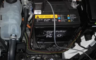

The Ioniq electric cabling looks a little different, the charge strategy is probably similar.
In Ioniq, the 12V battery cable (red line) (probably one wire) goes to the under the fuse box.
The LDC cable (yellow line) runs from all the way over on the left side of the compartment under the electronics boxes over to likely the same junction point under the fuse box.
The thin grey cable running over the battery is a two pair twisted shielded cable for the DCCT power and the 4_20 mA loop which runs out a convenient hole in the bottom of the car and then across the home to my lab. The blue donut battery upper left is the DC CT. (there is a connector on the CT, the grey cable comes out for driving)

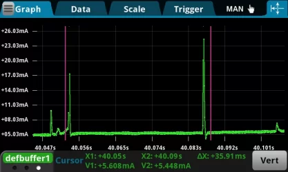

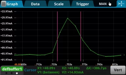

...So, the first odd thing is that I'm seeing readings approaching 30 mA (4-20 mA loop, with some under range to -10A), which assuming the sensor is working properly means some over scale reading above 50A.... Is that just charging some capacitors somewhere, starting the LDC?, or are there two very short (300 microseconds), short circuits?
I'm unsure that the LDC would wake up just to support a request from BlueLink. Checking LDC output would clearly show if it does, as possibly would the accompanying battery terminal voltage. I think though the takeaway is that the current draw due to a BlueLink request is short, under 1 second at about 22 amps, 79 mWh if my math is correct. Could the 300uS pulses coincide with receiving the request?
