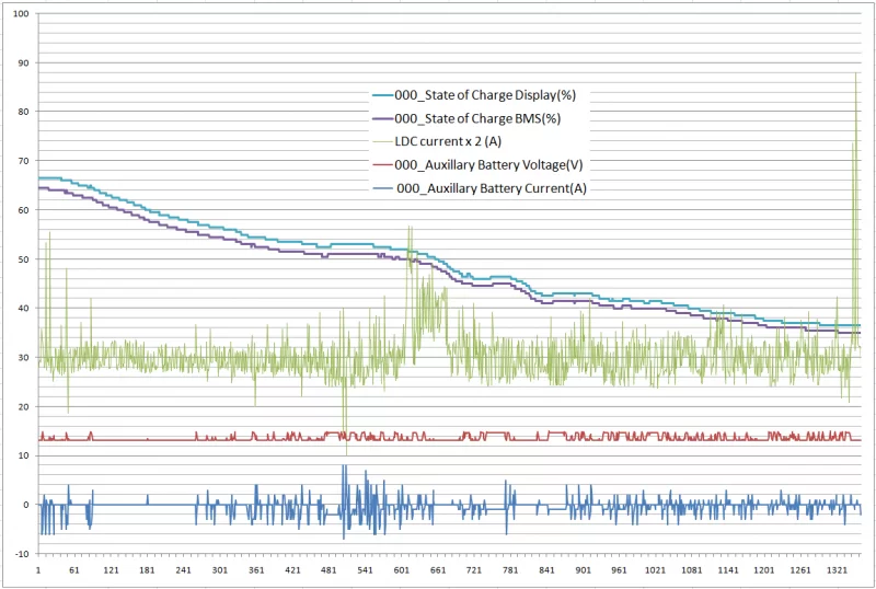

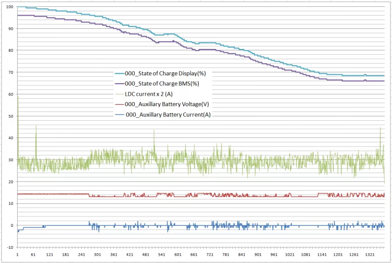

I logged some more extensive time today on the aux battery parameters with a 295 km round trip, 5 second logging interval. The bottom line is that the aux battery average voltage was 13.77 first leg, 13.55 return leg. The average aux battery current was -0.15 A and -0.35 A respectively, where negative is charging. Range was 13.1 to 15.0 and 13.0 to 15.0 V.
Ignoring spikes, those don't seem to be wildly out of line. We need similar data from someone who has had the battery fail.
I'm not exactly sure why the aux current was so much more excitable on the return trip but perhaps because I had the fan on much higher because it got warm then had to turn on the AC. Note, LDC current data has been doubled to keep the curve away from the others.
View attachment 7391 View attachment 7392

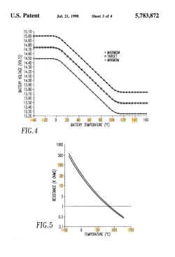

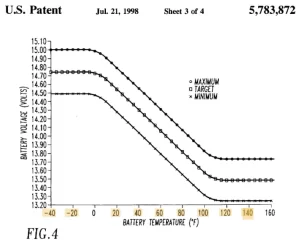

... I have no idea where the threshold temperature is for changing behavior yet..
I thought it might be worth searching for patents on the subject to understand the technology. It didn't take long to run into this relevant information at https://patents.google.com/patent/US5783872A/en which is from Northrop Grumman, way back in 1996. There are more modern patents from Ford, LG Electronics and even Hyundai, the latter at https://patents.google.com/patent/US10377237B2/en which specifically refers to "LDC control".
This 2012 Hyundai patent is a bit more readable https://patents.google.com/patent/US9413182B2/en
It's no surprise to me that the engineering is very well considered, but also that the company patents every idea they develop.
Pretty specific details there, with the various controllers and their functions - a lot to consider( a lot more than I could have originally perceived ).
Seems like overkill just to charge a 12 V battery, maybe they over thought it?
