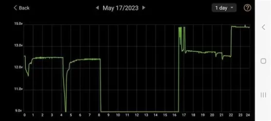

My battery has gone down to about 5V twice since my last software update in January. Once after the hood was open overnight and once after the hatch was ajar overnight. On other cars this wouldn't have drained the battery so drastically so I am wondering if this is bluelink panicking? I have never enabled bluelink but maybe the dealer did for their software update? IDK, but how does one check to see if bluelink is active, and if so how do I turn it off?
This happened to me yesterday.
I left the hatch open the afternoon of May 16, and the car unplugged. I assumed that after a short time, the car would turn off all lights and 12v systems like any normal vehicle. But our Hyundais are more creative than that! The open hatch kept things going for about an hour.
Then every four hours when it tried to charge the 12v battery, the car systems woke up, including the open hatch, the charge algorithm took a look and decided not to get involved, and things ran for another hour. After the fourth time, there wasn't enough left in the 12v battery to turn systems on.
At 4 pm I found the corpse and revived it with my 12v jumper pack. First thing I did was to close the hatch, then remembered the jumper pack was in the back. But I always leave it up against the back of the rear seat, for just such a situation.

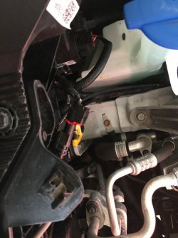

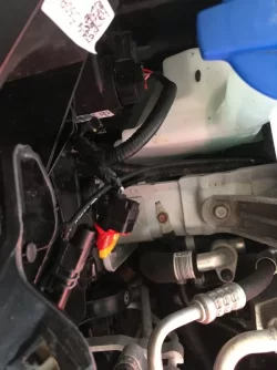

Having had similar experience I have pulled the plug to disconnect the bonnet sensor and installed a switch to turn off the light in the boot.

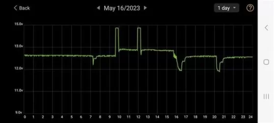

Your wish is my command, Sir.:)
At 1335 the car was started and my wife took a short shopping trip. The second spike around 1400 is when she started the car to come home.
On arriving home it appears the boot was left not properly closed (not by her, I hasten to add, she knows better than that:), but by a tradie who lifted a heavy object out of the boot for her).
The rest of the 24 hour period continues the next day.....
At 1231 I started the car to check on the behaviour of the smart cruise control (discussion over on SpeakEV), which I couldn't do in the garage because "SCC conditions not met" was displayed on the dash. I did not feel like going for a drive to meet SCC conditions, so shut the car down. It was during this time that I noticed the "boot open" warning. I closed the boot and then did the voltage checks with a multimeter.

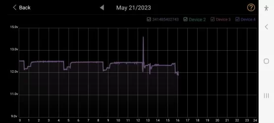

I reported above that the voltages were 12.1 at rest (the lesser of the two dips around 1311 on the graph)and 14.6 when I started the car. The car was on for less than the battery monitor's two minute reporting interval so that spike was not captured and does not appear on the graph. Also, the peak voltage was 14.23, not 14.6 as I reported.
At intervals the BM2 is reporting battery level at 32%

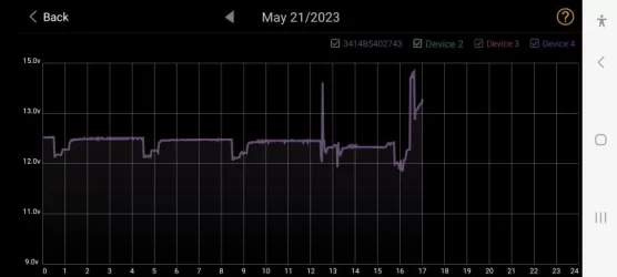

At about 1627 I connected a Ctek MX 7.0 charger in its conventional wet cell mode. The spike to 14.67 volts is the charger doing its thing to determine if desulphation is necessary. It then settled into its Bulk charging mode (constant current), which on this model is 7 amps. You can see at the end of the trace the voltage rising as the battery accepts charge.

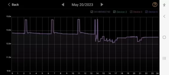

Question: What are the dips occurring every 4 hours from about 2030 on May 20 to about 0830 on the 21st? (I suspect I interrupted another one with my unsuccessful SCC test at 1231 on the 21st.)

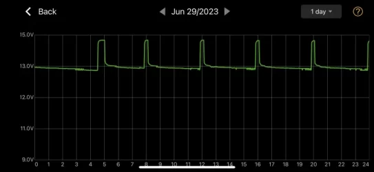

As mentioned above, these are probably the Hyundai algorithm trying a periodic 12v battery charge, noticing something out of the ordinary, and giving up - but not before waking up the car's systems so they can suck another chunk out of the 12v battery before going back to sleep.

Bonnet sensor connector1.webp Bonnet sensor connector2.webp Shows the location of the connector plug for the bonnet sensor. I've put red insulation tape on it and partially reinserted it to prevent muck getting into the plug.
