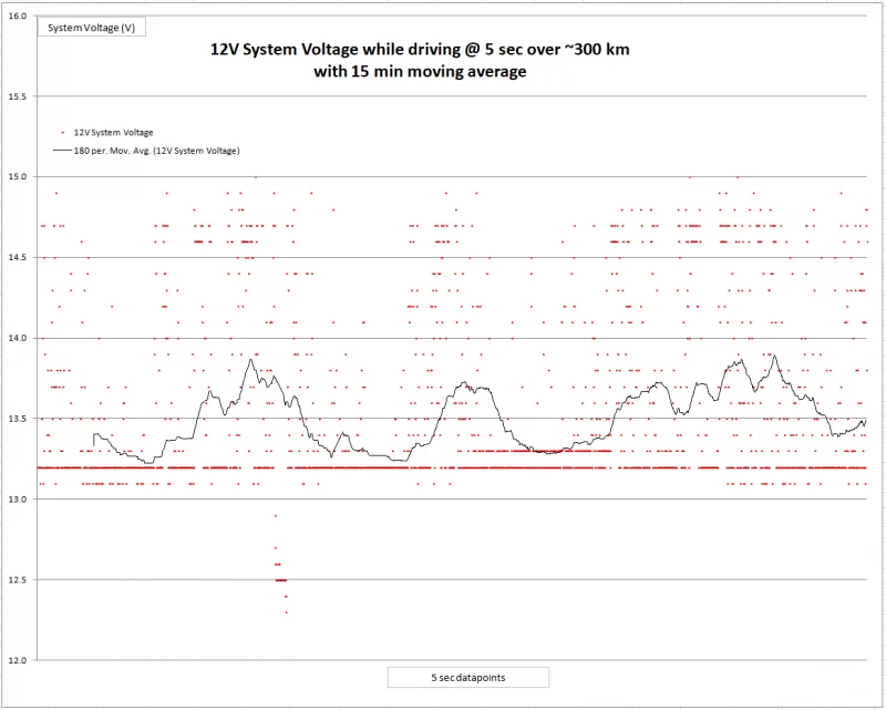

In short, it used to charge for the first 30 min of driving (for the day) as it still does for the first 30 min of (traction battery) charging. Since the Campaign 196 update that was carried out on all examples during 2019, it doesn't charge while driving anymore -- but it doesn't drain the battery either. It just "dithers" around, see graph below, noting that "charging" requires around 14.6 V. And, instead of a daily 20 min charge we get six a day for the first 60 hours parked then back to daily.

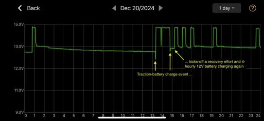

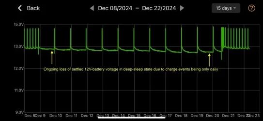

Here's an example of what happens when the (1st-gen) Kona goes into a deeper sleep state after ~56 hours parked, noting that it's a 15 day scale on the first image. The 12V battery suffers a gradual loss of charge.
A solution might be to set a scheduled traction-battery charge for 1 hour per day AND a charge limit of say 50% (or whatever it happened to be left with).
The portable EVSE would be left plugged in it and set to the lowest current, or drop the current setting on the dash.
The Kona will attempt to start a traction-battery charge event once a day but (theoretically) not succeed until the traction battery charge drops by 1%. A 1% charge takes around 1/2 to one hour and that will kick-start a new round of 12V battery charging for the next 56 hours.

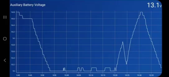

Long story short, the 12V battery died and I replaced it over the weekend. I decided to fire up CarScanner and keep an eye on the voltage to satisfy myself it was charging properly, and that's when I noticed some weirdness.
On startup everything was at ~14.6v as normal. I noticed that it would drop to ~13v when I put it in drive, UNLESS it was regenning.. e.g. I let off the throttle, voltage climbs back to ~14+v until I come to a complete stop. See attached screenshot I captured as I stopped at a light; 14.8v when coasting (Level 1 regen), drops to 13V when I come to a full stop, a little bump when I move forward in the queue, then come to a stop again (back to 14.8v and down again). The graph matches the throttle position basically perfect.
This morning I watched it again and it was ~14.6v the whole trip. On the way home it was doing this again.
I like to think I would have noticed this sooner since I usually have CarScanner open on longer trips, so this is a new flavor of weirdness. Any ideas what might be going on? Did the battery dying cause something to get scrambled, or did something break causing the battery to die?

It's all normal behaviour. Check a modern ICE car, it's the same, charges while slowing down to maximise economy using a so-called "smart" alternator.
That would make a lot of sense if it did it consistently. Like I said it's not something I've ever noticed before, and I usually connect CarScanner when taking anything I would consider a "long trip" (100+ mi in a day). It didn't do it Tuesday, Wednedsay, or Thursday (today) morning. It didn't do it this afternoon. It did do it Sunday when I took it for a ~50mi drive after replacing the battery, and it did it Tue and Wed afternoons. The inconsistency is why I'm feeling sus about it.
