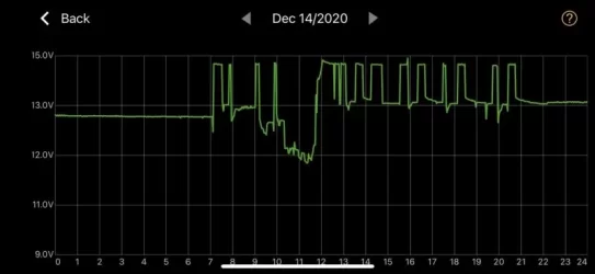

The outcome from the 13th onwards, 4 of the 5 graphs, is grossy affected by drama inflicted by the Aerovironment EVSE and so analysing charging behaviour for the 12V battery is unnecessarily complicated.
To better analyse this IMO you should (1) make sure the 12V battery is properly charged (use a 12V battery charger {with (-) on the chassis ground} or Utility mode for several hours. And (2) stick to the portable unit for a week and gather some clean BM2 data with the same useful annotations. Don't worry about the IBS just yet, it might be just fine.
Tool worker as you suspect your 12V battery is fried. Your experience mimics mine almost exactly, I was experiencing pretty much monthly dead batteries until the summer when the low voltage was finally affecting the car even while driving. My dealer finally gave me a new battery 6 months after I took delivery of the new Kona and I have yet to jump start my car in the past 4 months. That is a personal best :)

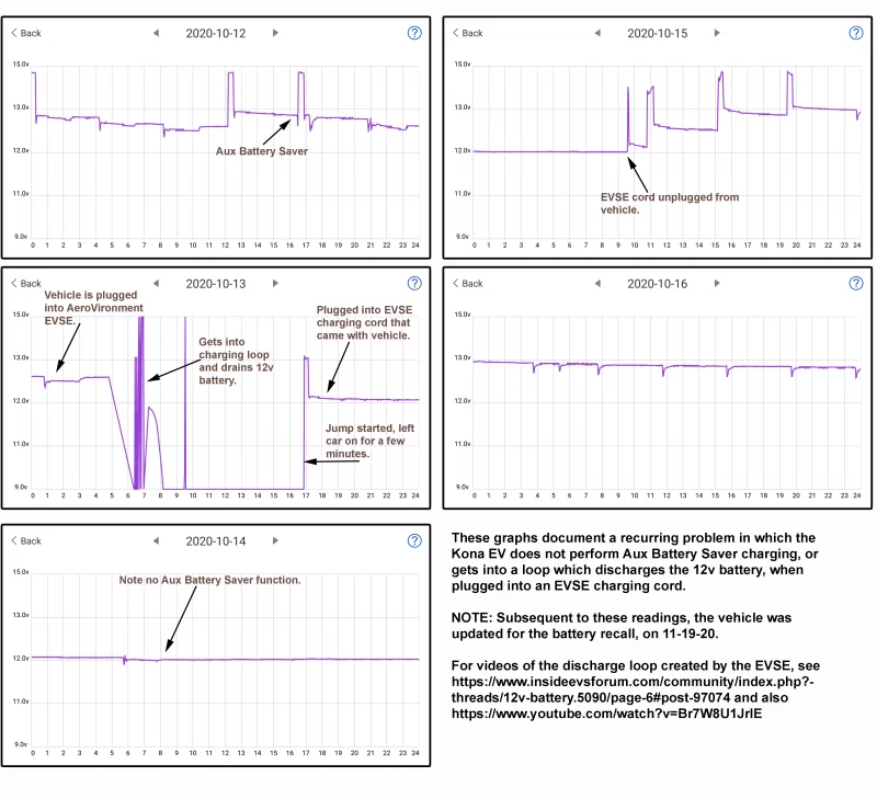

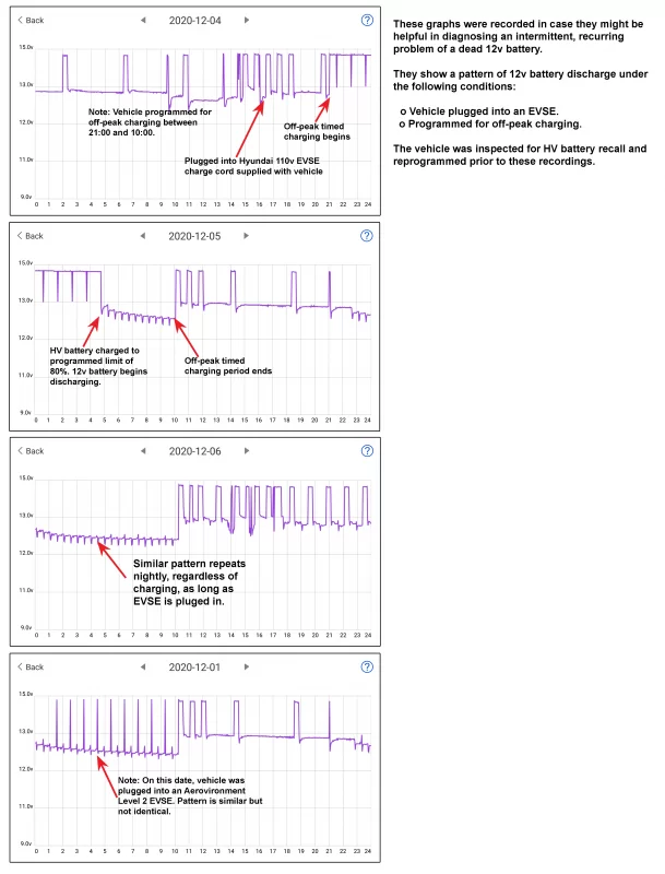

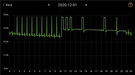

Here's something I haven't seen before. My Kona EV was plugged into the Aerovironment EVSE, a situation that has created many entertaining graphs in the past, so I offer this more for amusement than for any possible edification.

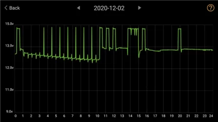

The car was plugged into the Aerovironment EVSE from the evening of Nov. 30 until it was driven at 2 pm on Dec. 2. The car is programmed to charge from 9 pm to 10 am.
This is what it looked like from the EVSE's side:
The car had the battery recall last month.
On the face of it, it appears that the Kona has increased the ABS charge frequency to hourly, to make up for the overnight beating laid down by the Aerovironment, but only after the EVSE "let go" at 10am.
That additional charging carried on past the normal period during the drive from 2pm (2 Dec). In normal circumstances it would have only charged for the first 1/2 hour then sat at ~13.0 V for the remainder.
Overall, the aux battery looks to be holding up quite well and the IBS and BMS appear to working as we might expect.

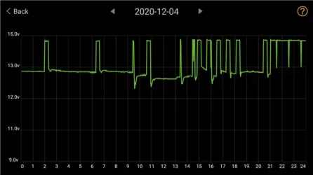

Around 4 pm on the afternoon of the 4th, the vehicle in question was driven, and subsequently plugged into the Hyundai 120v EVSE cord. It again began charging at 21:00, as controlled by the vehicle. During this period, the 12v battery was held at perhaps 14.8v, as it was during the Aerovironment's 1:44 of charging on Nov. 30.

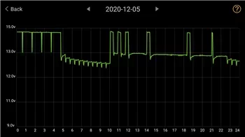

At the completion of the charging to 80%, around 5 am, there commenced an "overnight beating," to use the prosecutor's inflammatory characterization. It continued until the 10 am end of the programmed charging period. Apart from the short spikes on the earlier graphs, the 12v decline was almost identical to that during the beating allegedly administered by my client, the Aerovironment, days earlier. But, your honor, in this instance my client has an unshakable alibi - it was not plugged into the vehicle.
In fact, the common element in all instances is the vehicle itself. Clearly, the car is beating its own battery! [Jury gasps.]

Again, to clarify, my EVSE client was not programmed for charging times. It is the Kona that is programmed to charge between 9 pm and 10 am. The latest 12v charging algorithm apparently takes this into account.
While the portable EVSE was charging from 21:00 to about 05:00 it's unusual that it kept the 12V system at 14.8 V for the duration, additionally checking something at 30 min, then every hour. It must have either thought the aux was badly discharged, or is restarting the charge sequence for some reason which will re-initiate the aux charging period. My money is on the latter because the aux battery seemed pretty well charged at the start.
Normally it would be 14.8 V for the first 30 min, subsequently 13.0 V, then after 05:00 we should only see the aux battery open circuit voltage until the next ABS event.
The subsequent 30 min drops till 10:00 are just as weird and I'll grant certainly does match the prima facie behaviour exhibited by the accused Aerovironment. Is there any activity from the app that occurs at 30 min intervals? It seems to be processing the sequence similar to what happens when the J1772 is plugged in.
One likely difference between the portable EVSE and the Aerovironment is that the former will not care about a step by step procedure at start of charging, it will respond immediately to any request from the car (simply the resistance value placed on the CP line to the ground wire) without requiring any prior step be completed first. That might be why the Aero sometimes fails to start, it's just more pedantic.
The nearly perfect timing of the disturbances do suggest that something related to timers may be the root cause here. Perhaps a reset of the media unit might be an idea, given that this is what kicks off charging based on time. On another traction charge night, perhaps log off the app, if that's possible? I don't have the app so have no idea how it works.

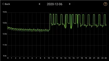

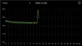

Let me rephrase.

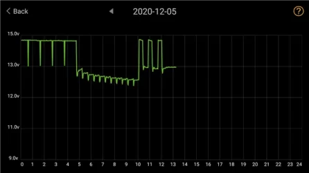

Does anyone else who has had the recent recall observe this pattern of suspending 12v charging and drawing down the 12v battery during the timed part-peak charging period when the EVSE is plugged in but the high voltage battery is not being charged?

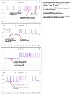

The pattern is shown above. The programmed charging period is 21:00 to 10:00. HV charging completed around 4:45 on 12-5. The Hyundai EVSE cord is plugged in.

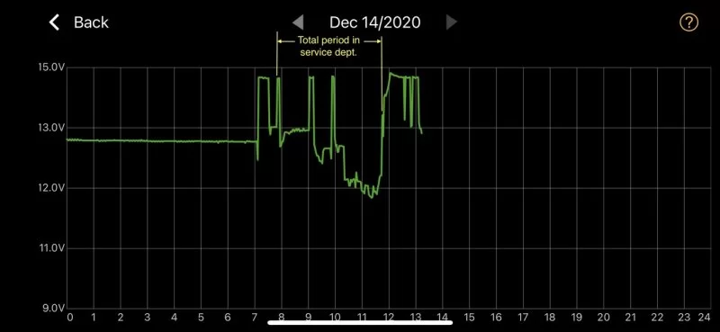

So, today at 16,000 km I had a year's worth of firmware updates applied today and a 24 month/30,000 km service. The first BMS update is skipped and there is the latest one plus another for something else, I'm unsure what.

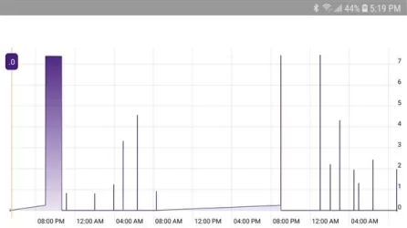

Here's what the BM2 revealed as to how much of a bashing the aux battery received. It looks like it held up well to the 10:00 to 11:40 update process but you can see that there's no question that it's under stress during this time and who knows at what reduced voltage things turn pear-shaped. It does appear that they had put the car in Run mode for 10 min beforehand as I understand the TSB dictates, referring to the pulse at 10am and/or possibly the one at 9am. When I picked up the car at 12:30 it was on a 25kW Delta EVSE and was up to 82% (from 59 at drop-off). You can see that the aux battery was charging for nearly an hour prior and initially current-limited 11:50-12:00, meaning it was taking in more current than the LDC could provide.
The service included a brake fluid change and they billed me for a litre so I'm assuming they really did flush the system out and that might explain the first part of the graph. I was happy to see that they hadn't spilt any fluid around the reservoir filler but there was a drop on the plastic cover over the heat pump valves, easily cleaned off. I'd guess they use a machine to force-feed fluid to the MC so they can concurrently raise the car on the lift to get to the four bleed screws.
I was also supposed to get the new HV fuse campaign applied but they said there were no parts available in the country and 44 Konas in total were affected in NZ. According to the repair sheet the fuse change is to resolve poor AC performance, an issue I don't seem to have. No doubt the brake system campaign will show up soon as well but it wasn't available today.

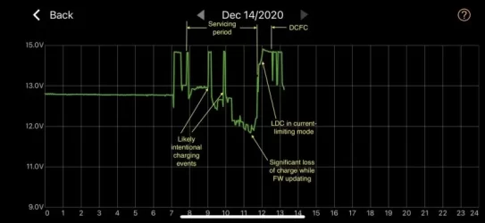

Yes I would say the accessory battery was a hurting unit at that 11:30 period but seems to have taken the punishment well. Good thing it was at a high SOC when you brought it in.
Thanks for the well detailed graph displaying the affects of the update process ;)

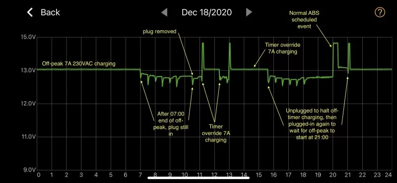

I further annotated yesterday's graph in case some details were not clear.

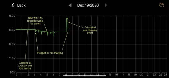

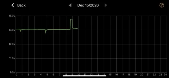

After yesterday's, "assault on battery" and subsequent multiple aux charging events I'm happy to see today that it's not over-doing it as I thought it might, keeping in mind that I have no remote app functionality drawing power and was perfectly happy with a once-a-day ABS.

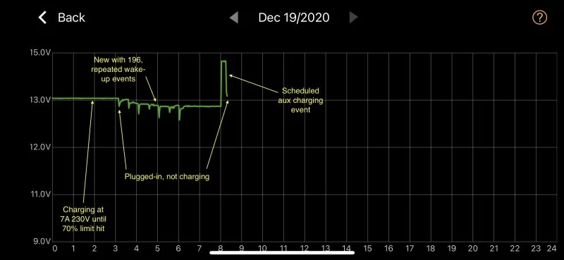

So, it does appear post-196 (BMS) update that the impact on the 12V battery of a plugged-in, powered, but not charging AC EVSE has changed. The car wakes-up every half hour 5 or 6 times. It doesn't seem to matter if it's a new plug-in in anticipation of timed charging, or if charging had just completed and the plug was left in place.
It appears to give up after approximately 3 hours. It seems to have much the same impact on the aux battery as unlocking and opening a door. Not a lot, but not insignificant.

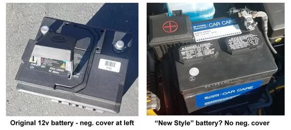

BTW the service adviser said the new battery (on the right) is the correct replacement part, just a new style that they're using now. Seriously?
