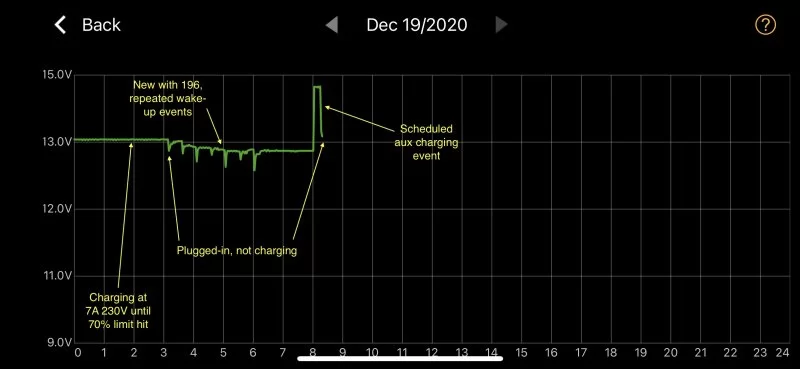

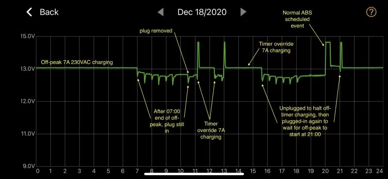

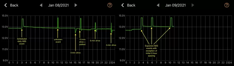

So, it does appear post-196 (BMS) update that the impact on the 12V battery of a plugged-in, powered, but not charging AC EVSE has changed. The car wakes-up every half hour 5 or 6 times. It doesn't seem to matter if it's a new plug-in in anticipation of timed charging, or if charging had just completed and the plug was left in place.
It appears to give up after approximately 3 hours. It seems to have much the same impact on the aux battery as unlocking and opening a door. Not a lot, but not insignificant.

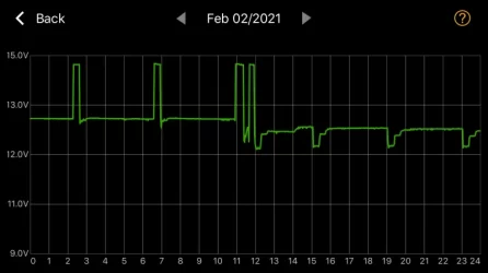

The difference between your graphs and mine is that your wakeup activity seems to give up after 3 hours, while mine continues for the full 13 hour off-peak charging period, and your battery voltage appears to stay above about 12.7 - 12.8v while mine drops down to 12.5v and sometimes close to 12.0.
