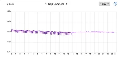

Can you post the BM-2 graph of all that?... Every four (+/-) hours was the battery drain event without the overlying recharge event.

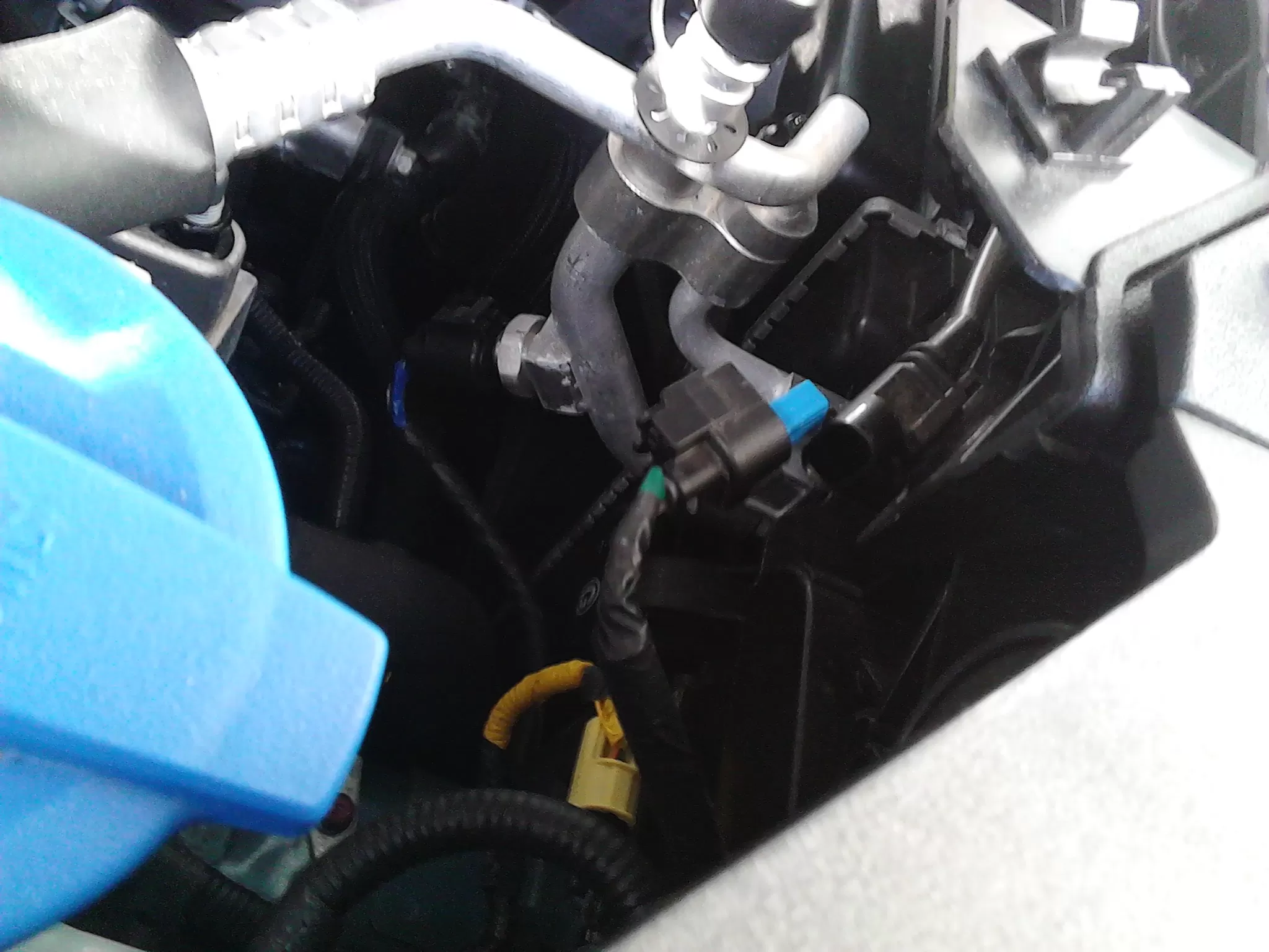

If it works the same as the front hood and only sends a signal that it is open(shows on the dash) than it should be no problem as I have already disconnected the front one (temporarily to see the results), the only issue being the alarm goes off if opening it when vehicle not in run mode.Yes, that thought had occurred to me as well but I suspect it would harder than it seems because of the control logic still needed between the switch and the electric latch actuator.

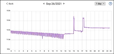

It's interesting that after 19 hours of tailgate ajar the battery is not badly depleted at 12.5 V and did not continue to deteriorate. And, that a single aux charge event was enough to restore the voltage to better than it was before....In screen shot two (above), the normal "parade pattern" returns after I discovered and correctly closed the tailgate at 0545.

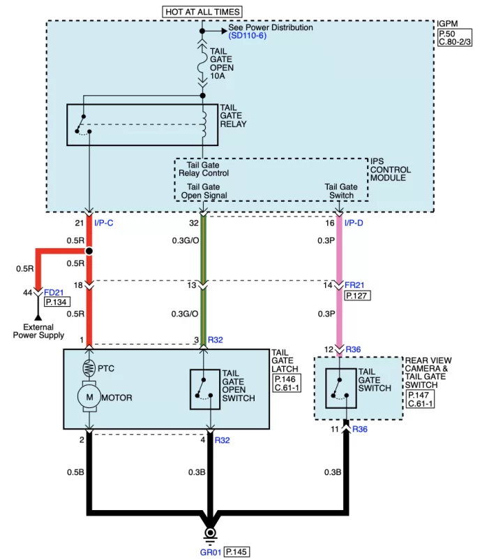

R32 (Tailgate open switch pin 3 and 4) is the one I am thinking and the wiring diagram confirmation is appreciated. R36 not sure of (maybe signals as John Lumsden above post) At least the wiring color code should help.This might help, EE. It's fooling the IPS Control Module firmware that's the concern.
But experimentation with the two switch conditions might lead to a suitable solution.
