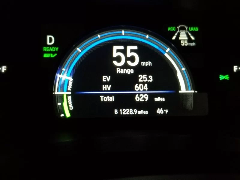

Yikes, mine is getting worse! Honda really needs to do something about this loony algorithm. It's just whacked. I took a shot of my new range after I just filled up today. I mean, good grief, base the HV range on the EPA estimate of 42mpg or something close to that. That's just a no-brainer.

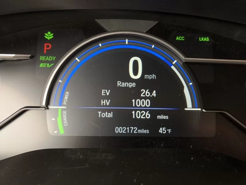

I would love to have a stated gas range of 380. How would you like an absurd predicted range of 1,000 miles as my picture depicts?

Yes, a bunch of these gauges crap out at 999.9! (not factorial)
