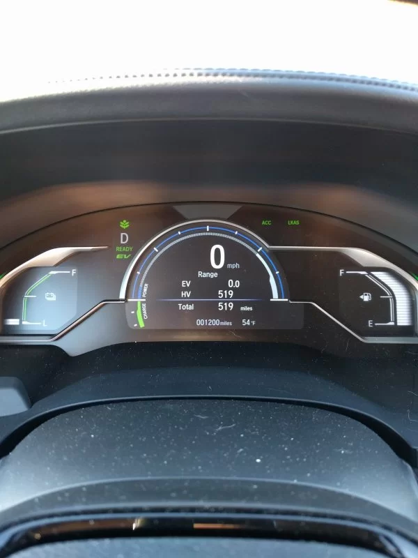

Has anyone else seen falsely high HV ranges reported on the Clarity PHEV? After my last fillup of the 7-gallon tank, it reported 464 HV miles; this time it went to 519!
Unfortunately my highway driving is in practice getting more like the 40-45 mpg advertised. The range only changes when the ICE is running, but falls much faster than the distance I drive, proportional to the amount of gas left.

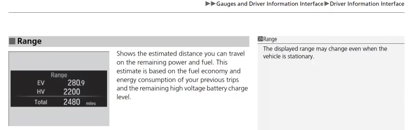

The manual doesn't shed much light on the question. One example shows HV 2200.
Also, the manual writer confuses power with energy ("remaining power and fuel"). The driver's meter curve shows power, the power being drawn (or returned) the system ("watts"). The stored energy is watt-hours, e.g. 14 kWh used in a drive.
