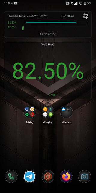

Had the update last week, yesterday i did charge to 82.5% to test the claim that there is a 10 minute delay once reaching 80%. there is none. I found no difference in charging speed/curve on a 150kw fast charger
