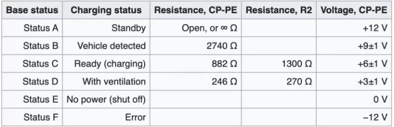

On AC chargers, it could end up stopping / charging you idle fees, although 1kw is probably enough to keep the charger "alive".
To be clear, it's the EV's resistive load on the CP-PE signal that maintains the AC session, not the power draw, Status C below.
