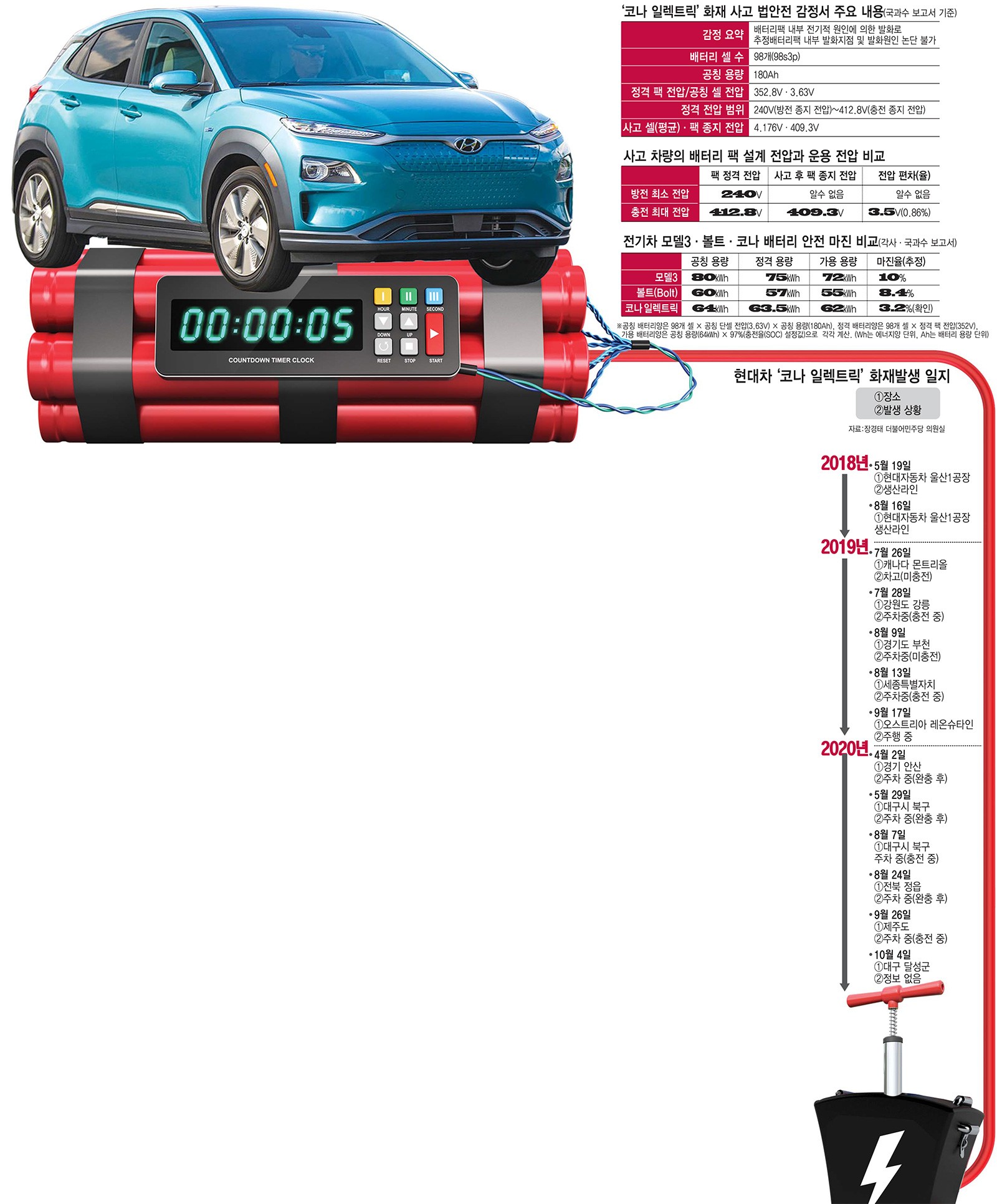

And here is an image from the Korean press - you don't have to read Korean to get the implication. This can't make Hyundai happy.

I wonder why they used a Leaf for the header picture, otherwise a good report.
Here's the list of events at the right column, as best as I can determine using google translate and reformated in a text editor. The latest event is not included.
2018
May 19
① Hyundai Motors Ulsan Plant 1
② Production Line
August 16
② Production Line
2019
July 26
① Montreal, Canada
② Garage (uncharged)
July 28
① Gangneung, Gangwon-do
② Parking (charging)
August 9
① Bucheon, Gyeonggi-do
② Parking (not charging)
August 13
① Sejong Special Autonomy
September 17
① Austria Leonstein
② Driving
2020
April 2
① Gyeonggi Ansan
② Parking (after full charge)
May 29
① Buk-gu, Daegu City
August 7
① Parking in Buk-gu, Daegu City (charging)
August 24
① Jeongeup, Jeonbuk
September 26
① Jeju Island
October 4
① Dalseong-gun, Daegu
② No information

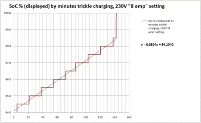

I doubt any cell balancing occurs under highly-dynamic charge or discharge situations, or even at any time other than at the end of a full charge event.
More practically and from appearances, when charging reaches about an indicated 98.5%, charging current is paused and passive balancing proceeds which dissipates charge from cell parallel groups with higher voltages than the others into local resistors. Alternatively, some current can be shunted past those groups with higher voltages while the others catch up.
Once all cell group measure voltage within an allowed tolerance, then the SoC increments directly to 100% and charging is effectively done. Some of us have seen this SoC jump suddenly when cells are already well-balanced.
The schematics show (5) CMS (assuming 'cell management unit') that individually handle two each of the total (10) packs and are located nearby. The CMS units appear to be centrally managed by the BMU (presumably 'battery management unit'). It's not totally clear but I suspect that 'BMS' refers to all those parts as a system.
